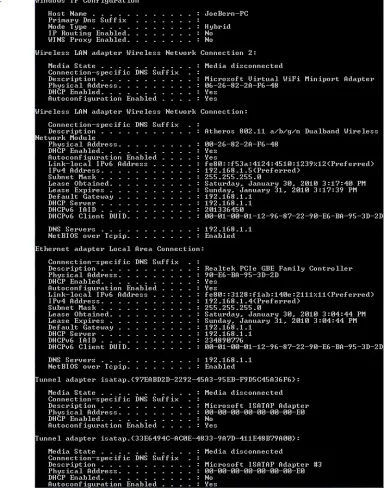

You can also type ipconfig /all and post the results back here.

Joe, Just took another look at post #8, and everything looks good except
1. I see you haven't disabled IPv6 on either adapter, try that and reboot
2. I see that your ip addressing scheme is using your router for default DNS resolution, try setting it manually to 8.8.8.8 preferred and 8.8.4.4 alternate just to see if it's having a problem forwarding. Reboot again
The reboots shouldn't be necessary, but they won't hurt
