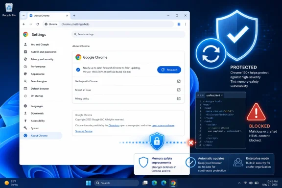

For consumers, the procedure is:
- In Chrome, open Menu (⋮) > Help > About Google Chrome.
- Allow Chrome to complete the available update.
- Select Relaunch.
- Return to the same page and verify that the version shown is 150.0.7871.46 or later.

- Open Google Chrome.
- Select Menu (⋮) > Help > About Google Chrome.
- Wait while Chrome checks for and applies the available update.
- Select Relaunch.
- Return to About Google Chrome.
- Confirm that the version shown is 150.0.7871.46 or later.
