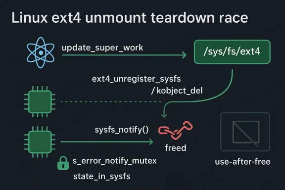

Diagram showing a Linux ext4 filesystem unmount teardown race with functions like sysfs_notify and use-after-free.What Happened in update_super_work
At the center of the issue is a delayed work item named update_super_work. That work item runs during ext4 shutdown and can still try to report an error through sysfs, even as the superblock is being dismantled. The vulnerability description lays out the sequence plainly: ext4_put_super calls ext4_unregister_sysfs, which invokes kobject_del(&sbi->s_kobj), removes the sysfs directory, nulls out kobj->sd, and eventually frees the kernfs_node; only later does the code reach ext4_journal_destroy and flush s_sb_upd_work.
Thacause sysfs_notify expects the kobject’s sysfs backing to still exist. When update_super_work runs late enough, it calls ext4_notify_error_sysfs(sbi), which in turn calls sysfs_notify(&sbi->s_kobj). By then, the kernel has already freed the associated kernfs_node, so the notification path dereferences a stale pointer and trips a use-after-free condition.
Why the race is realract possibility. The teardown and delayed-work lifetimes overlap by design, and the vulnerability record shows the exact window in which the stale pointer becomes reachable. The critical detail is that ext4_unregister_sysfs now runs before flush_work(&sbi->s_sb_upd_work), so the work item may still fire after sysfs has been partially dismantled. That is a classic shutdown-time race: one thrent new work from being queued, while another is still allowed to execute already queued work.​
The dangerous part is that the kernel usually expects teardown to be idempotent and conservative, but sysfs notifications are not no-ops if the backing object is gone. They can walk through object state that has already been invalidated, which turns a harmless-looking “notify” call into a memory-lifetime hazard. In practice, that means the bug is hard to trigger casually, but very plausible during unmount stress, error handling, or workloads that cause ext4 to emit status updates late in teardown.

The vulnerability is ultimatelme, not ext4 metadata logic. The Linux documentation makes clear that ext4 exposes per-filesystem state under /sys/fs/ext4, so the filesystem’s internal objects are tied to a sysfs representation that must be created, maintained, and destroyed in sync with mount state. If teardown gets ahead of notification, the filesystem can still believe it has a valid kobject while sysfs has already reclaimed the internal node backing it.
That is why kobject_del is such a sensitive point in the sequence. Once the object is removed from sysfs, the kernel may release the backing kernfs_node, and any later call that assumes the node remains present is on thin ice. In the CVE description, the stale pointer is specifically kobj->sd, which has been nulled and freed before sysfs_notify tries to acquire a reference again.
Why state_infix hinges on a small but important state bit:s_kobj.state_in_sysfs. That flag tells the code whether the kobject is still registered in sysfs, and the patched logic uses it as a gate before attempting the notification. If sysfs teardown has already happened,ext4_notify_error_sysfssimply skipssysfs_notify` altogether.​
That is a much cleaner answer than tryld ordering everywhere. It recognizes that a notification after sysfs removal is not useful enough to justify touching freed memory. The behavior becomes fail-quietly rather than fail-dangerously, which is exactly what shutdown code should do.
The state bit alone is not enough, though. Without synchronization, a thread could observe state_in_sysfs as true, then lose the race to kobject_del before the actual notify call executes. That is why the patch also introduces a dedicated mutex, s_error_notify_mutex, to serialize ext4_notify_error_sysfs against ext4_unregister_sysfs and prevent a TOCTOU race between the state check and the actual sysfs operation.

The dedicated s_error_notify_mutex closes the race window that would otherwise remain even after checking state_in_sysfs. That matters because the object’s state can change between the check and the notify call if another CPU reaches the unregister path first. By serializing the notification path with kobject deletion, the kernel prevents the exact TOCTOU pattern that makes use-after-free bugs so hard to tame.
