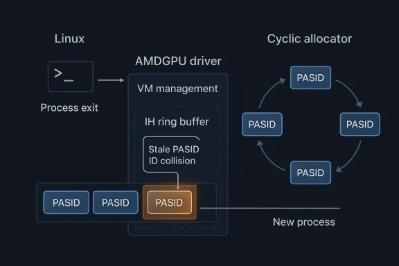

Diagram showing Linux AMDGPU driver VM management with PASID and cyclic allocator handling PASID collisions.What PASID reuse actually means​
At a high level, a PASID lets the GPU associate work with the correct process addre the hardware and driver to maintain a per-process view of memory and faults. In AMDGPU’s VM-oriented interfaces, PASID management is explicitly part of the driver’s job, not an optional optimization.
The danger in immediate reuse is that hardware does not always stop thinking the instant a process exits. Interrupts can be deferred. Faults can process with the same identifier may arrive before the system has fully forgotten the old one. That is where the bug lives: not in the existence of PASID allocation itself, but in the assumption that an identifier is free to reuse the moment software says so.

A useful way to think about it is this:
  • A process exits and frees its PASID.
  • Pending page-fault interrupts are still waiting in the GPU’s interrupt handling path.
  • The allocator to a new process.
  • The hardware and driver now have a stale identifier collision.
  • The new process inherits the operational confusion of the old one.
That sequence is not an abstract design concern. It is a classic example of what happens when a supposedly dead object is resurrected too quickly. Kernel developers see these problems often enough that the fi: slow down reuse, widen the reuse window, or add lifecycle barriers so the old context truly disappears before the new one appears. Here, maintainers chose the reuse-delay approach.
Why the fix uses cyclic allocation​
The most interesting part of the fix is the allocator choice. The CVE description says the PASID allocator now uses the same cyclic strategy that kernel PIDs use. That is a very Linroblem: not by banning reuse forever, but by making immediate reuse unlikely enough that stale state has time to drain.
This is elegant because it preserves the resource model. PASIDs are finite. You cannot simply keep issuing new ones indefinitely without eventually wrapping or exhausting the namespace. A cyclic allocator naturally balances reuse and freshness. It donent tombstone; it simply avoids the dangerous “same ID right away” path that causes the collision.
