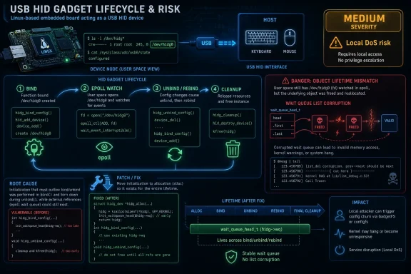

Infographic diagram shows USB HID gadget lifecycle and risk of Linux DoS from object lifetime mismatch.The Vulnerability Lives in the Space Between “Configured” and “Gone”​
CVE-2026-31721 sits in the Linux USB gadget subsystem, specifically the f_hid function driver that lets a Linux system present itself to another machine as a USB Human Interface Device. In plainer English, this is the machinery that allows a board, phone, test fixture, or embedded Linux device to behave like a USB keyboard, mouse, joystick, barcode scanner, or other HID-class peripheral.
That immediately narrows the affected world. This is not the same thing as plugging a malicious keyboard into your Windows laptop. It is about Linux machines that act as USB devices rather than USB hosts, and about software that opens /dev/hidg0, watches it through epoll, and then survives a USB Device Controller unbind and rebind operation.
The reported sequence is precise: set up and bind an HID gadget, open /dev/hidg0, add the file descriptor to epoll, unbind the UDC, bind it again, and then remove the file descriptor from epoll. With CONFIG_DEBUG_LIST enabled, the kernel reported list corruption inside remove_wait_queue, reached through epoll’s cleanup path.
That path matters because epoll is not a decorative detail. It is the standard Linux mechanism that serious event-driven software uses to watch file descriptors efficiently. If the kernel object backing a file descriptor is partially reset while user space still holds a reference to it, the kernel has turned a legitimate programming pattern into a trapdoor.

The Root Cause Is an Object Lifetime Mismatch​
The fix is conceptually small: move list and spinlock initialization from hidg_bind to hidg_alloc. In kernel terms, that is not a cosmetic refactor. It changes the lifetime boundary of internal synchronization and queue structures so they are initialized when the HID function instance is allocated, not each time the function is bound to a USB Device Controller.
The old behavior effectively treated bind as a safe moment to initialize wait queues and related state. That assumption breaks if user space still holds a file descriptor whose polling machinery has registered itself with those queues. Reinitializing a wait queue while it still contains entries is like replacing the guestbook while guests are still signing out; the next removal operation no longer sees the structure it expects.
The CVE text says the problematic queues were registered through poll_wait. That is the bridge between the HID gadget file descriptor and epoll. User space asks the kernel to notify it when the file descriptor is ready; the kernel records wait queue entries; later, epoll removes those wait queue hooks. If a bind operation reinitializes those queues in the middle, epoll’s cleanup may attempt to delete a list entry from a list that has been reset underneath it.
That is why CONFIG_DEBUG_LIST saw corruption in list_del. Debug-list checking is designed to catch list manipulation bugs early and loudly. Without that debug configuration, the same conceptual bug may not produce such a tidy diagnostic; it may instead manifest as a crash, warning, or harder-to-reproduce memory corruption symptom.

Epoll Turns a Stale File Descriptor Into a Kernel-Lifetime Test​
The trigger sequence in the CVE is revealing because it depends on holding a file descriptor across a device lifecycle transition. That is a common stress point in kernel code. User space sees a file descriptor as a stable handle until it closes it; device code may see bind and unbind as moments when hardware-facing state is created and destroyed.
The kernel’s job is to reconcile those two models. A file descriptor should not become a dangling promise just because the underlying hardware state changed. If a device is unplugged, unbound, reset, or reconfigured, cleanup paths must still be safe for the objects user space already holds.
Epoll makes these bugs easier to expose because it stores interest in readiness events. It does not merely call read or write once. It asks the kernel to maintain relationships between an epoll instance, a watched file, and the wait queues that signal readiness. Those relationships often outlive the moment that created them.
That is why moving initialization to allocation is the right kind of fix. The wait queues and locks belong to the function instance’s lifetime, not to each bind operation. Resetting them on bind was effectively pretending the object had been freshly born when parts of the system still remembered its previous life.

The Fix Is Small Because the Contract Was Wrong​
One reason this CVE is interesting is that the patch does not appear to introduce a new validation layer, permission check, or elaborate mitigation. It relocates initialization. That makes it a classic kernel maintenance fix: the code was doing the right operation at the wrong lifetime boundary.
Moving list and spinlock initialization from bind to alloc aligns the data structures with the lifetime of the function instance. Bind and unbind can then come and go without destroying the bookkeeping that epoll and poll paths may still depend on. The change is technically modest, but semantically important.
This is the kind of fix that rarely gets mainstream attention because it lacks drama. There is no branded vulnerability name, no logo, no widespread exploit kit, no urgent desktop pop-up. Yet these small lifetime repairs are how kernels become less crash-prone over time.
They are also why backports matter. A mature long-term kernel is not secure because it is old; it is secure because maintainers keep moving these small but consequential fixes into branches that real products still run.
