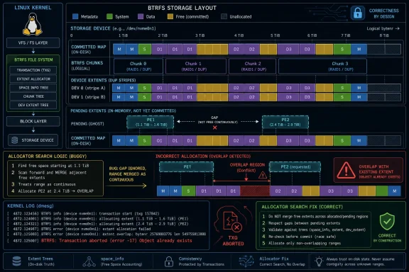

Diagram shows a Btrfs allocation layout with an overlap bug causing a transaction abort and correctness-by-design fix.A Filesystem Bug That Looks Like a Race but Isn’t​

The Bad Assumption Was Hidden in the Gap​
Btrfs allocates storage in chunks, and the bug lives in the logic that searches for free device space. The allocator looks through the device tree for gaps between existing device extents. It then adjusts those apparent gaps by checking for allocations that have happened in the current transaction but have not yet landed in the committed device tree.
Those in-flight allocations are called pending extents. They are not imaginary; they are real from the allocator’s perspective. They simply occupy a temporal gray zone between “known to this transaction” and “visible in the committed tree.”
The flaw was that the adjustment logic effectively treated the first pending extent inside a candidate hole as the only pending extent it needed to reason about. If the allocator saw a pending extent, it could move the apparent start of the free region past that extent and treat the rest as usable. That works when there is only one pending extent in the range.
It fails when there are two non-consecutive pending extents with a real hole between them. The allocator can skip the first pending extent, count the space beyond it as a single usable hole, and accidentally include the second pending extent inside what it believes is free space. The next allocation can then overlap an existing pending allocation.
That is the heart of CVE-2026-45934: the allocator mistook a fragmented free-space picture for a continuous one. It did not need wild memory corruption or a maliciously crafted image to get there. It needed a sequence of legitimate chunk allocation and cleanup behavior that produced a shape the old helper function did not fully model.
DUP Makes the Failure Easier to See​
The report calls out DUP chunk allocation, and that is a crucial detail. In Btrfs, DUP stores duplicate copies of metadata on the same device, giving single-device filesystems some protection against localized damage. It is commonly associated with metadata redundancy rather than multi-disk mirroring.
DUP also means a single logical allocation has multiple physical stripes. If the allocator misidentifies free physical space, the overlap can appear in one of those stripes. In the sample described with the CVE, one stripe from an earlier metadata DUP chunk overlaps a stripe from a later metadata DUP chunk.
That overlap is not a theoretical embarrassment buried in a debug table. It is precisely the sort of contradiction that can cause a later insertion of device extents to fail. Btrfs tries to record a device extent, finds that the physical range is already represented, and aborts the transaction.
The report notes that the observed path involved forced chunk allocation, typically behind CONFIG_BTRFS_EXPERIMENTAL. That may tempt some users to wave it away as a lab-only problem. The uncomfortable part is the caveat that the pattern can theoretically happen to any DUP chunk allocation.
That is the sort of wording sysadmins should read carefully. It does not mean every Btrfs filesystem is a ticking bomb. It does mean the bug belongs to a general allocator path, not merely to a test-only command.
