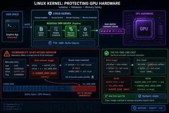

Diagram showing a Linux kernel fix preventing GPU hardware memory safety issues via bounds-check overflow handling.A One-Line Cast Exposes a Kernel-Sized Trust Problem​
The core of CVE-2026-46006 is not exotic. Nouveau’s nouveau_gem_pushbuf_reloc_apply() function checked whether a relocation offset plus four bytes would exceed the backing buffer object’s size. The problem was that the offset field, reloc_bo_offset, is a __u32, and adding the literal 4 kept the arithmetic in 32-bit unsigned territory before the result was compared with a larger size_t.
That means a carefully chosen offset near the top of the 32-bit range could wrap around before the bounds check happened. The comparison would then see a small number instead of the intended large one, potentially allowing an invalid relocation to pass validation. The fix casts the offset to u64 before adding four, forcing the calculation into 64-bit arithmetic and preserving the intended bounds check.
This is the sort of bug that makes security engineers wince because it is obvious only after someone points at it. The code is readable, the condition is plausible, and the intent is clear. But C’s integer promotion rules are doing something narrower than the human reader assumes.

Nouveau is the open-source Linux driver for NVIDIA GPUs, living under the kernel’s Direct Rendering Manager subsystem. DRM drivers do a difficult job: they expose enough functionality for user-space graphics stacks to submit work to the GPU while preventing those submissions from corrupting kernel memory, other processes, or the device’s own bookkeeping. That boundary is especially delicate because graphics workloads are built around buffers, offsets, relocations, command streams, and memory mappings.
The vulnerable code lives in push buffer relocation handling. In simplified terms, a push buffer is a stream of commands submitted toward the GPU, and relocations are the metadata that tell the driver how to patch or validate references to buffer objects. The kernel must assume that user space can be wrong, malicious, or both, so every offset and size calculation becomes part of the security perimeter.
That is why the arithmetic matters. The driver was trying to confirm that a relocation touched a valid four-byte region inside the buffer object. If the offset calculation wraps, the check can reason about the wrong address range. The bug is not that the driver forgot to check bounds; it is that the bounds check could be tricked by the type width of an intermediate expression.
In modern kernel security, those are often the most interesting failures. The unsafe operation is hidden inside a line that looks like defensive programming. The validation exists, but the validation itself rests on arithmetic assumptions that the compiler is under no obligation to share.

The commit text is unusually direct. It explains the vulnerable condition, identifies the type mismatch, and states the remediation: cast to u64 so the addition happens in 64-bit arithmetic. There is no elaborate redesign, no mitigation framework, and no sprawling subsystem refactor. The code changes from adding in 32 bits to adding in 64 bits.

  • The vulnerability arises from 32-bit unsigned arithmetic wrapping before a bounds comparison against the buffer object size.
  • The upstream fix casts the relocation offset to 64-bit before adding four bytes, preserving the intended bounds check.
