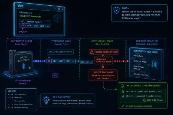

A One-Byte Packet Walked Into the Bluetooth Stack
The vulnerability sits in virtio_bt, the Linux driver that lets a guest operating system talk to a Bluetooth controller exposed through the VirtIO framework. VirtIO is the plumbing that makes many virtual devices fast and relatively clean: network cards, block devices, consoles, random-number devices, and, in this case, Bluetooth. The guest sees a device; the hypervisor or backend supplies the behavior.In the vulnerable path,
virtbt_rx_handle() reads a leading packet-type byte from an incoming receive buffer and then passes the rest of the packet into the Bluetooth HCI core. That first byte says whether the frame is an event, ACL data, SCO data, or ISO data packet. Each of those packet classes has a minimum fixed header size.The mistake was not validating that minimum before handing the packet onward. A backend could present a buffer that was technically long enough to contain the packet-type byte but not long enough to contain the header implied by that byte. Once the driver pulled the type byte off the front, the remaining socket buffer could be empty.
That sounds like a trivial malformed input case, and in a well-layered kernel it should be. The problem is that the next layer was willing to inspect fields based on the packet type. In one described path, an ACL packet classification routine can read the ACL handle field when certain Bluetooth ISO-related connection types are active, even though the buffer no longer contains the bytes that make up that header.
The Bug Is Small Because the Trust Boundary Is Not
A natural reaction to this CVE is to ask whether Bluetooth is remotely exploitable here. That is the wrong first question. The issue is not a random Bluetooth radio packet arriving over the air and popping a laptop. The CVE description points at an untrusted backend supplying receive buffers to a VirtIO Bluetooth device.That distinction narrows the blast radius, but it does not make the flaw academic. Virtualization has spent years turning what used to be local machine assumptions into distributed trust relationships. A guest kernel may be consuming input from a host process, a device model, a service VM, a testing harness, or an emulated backend written by someone else entirely.
In that architecture, backend-supplied is not a synonym for safe. It is a warning label. The backend might be malicious, compromised, misconfigured, fuzzing-adjacent, or simply buggy in a way that produces impossible packets. The guest kernel still has to defend itself.
That is why the patch is framed as hardening against an untrusted backend. The driver should not assume that because a virtqueue completion exists, the completed buffer is semantically valid. It should not assume that packet classification code downstream will be happy with whatever length remains. And it should not assume that a one-byte receive completion is harmless merely because a previous patch bounded the total receive length.
Header Lengths Are Boring Until They Become Memory Safety
The technical core of CVE-2026-46186 is a missing set of minimum-length checks. After removing thepkt_type byte, the driver now requires enough data for the relevant HCI header: two bytes for an event header, four for ACL, three for SCO, and four for ISO. If the length is too short, the packet is dropped and the error is rate-limited.That is the entire fix in spirit. It is not a cryptographic redesign, not a Bluetooth protocol overhaul, not a new mitigation framework. It is a reminder that input validation is not a ceremony performed once at the outer wall; it is a contract that must be renewed at every semantic transition.
The interesting part is the interaction with an earlier hardening change. The CVE text notes that a preceding patch bounded the backend-supplied
used.len value to a sane range, from one byte up to the receive buffer size. That closes one class of bad lengths, but it leaves a narrower malformed case: a one-byte completion is valid enough to pass the outer bound check and invalid enough to confuse the packet parser after the type byte is removed.That pattern shows up repeatedly in kernel bugs. One patch makes an input “safe” in a gross memory-allocation sense; the next bug emerges in a semantic sense. The buffer is not too large. It is not negative. It is not outside the allocation. It is merely too short for the meaning the code assigns to it.

The disclosed behavior describes an out-of-bounds read of two bytes of uninitialized receive-buffer data in a particular ACL classification path when active CIS, BIS, or PA links exist. That is narrower than arbitrary code execution. It is also not nothing.Out-of-bounds reads in the kernel can have varied consequences. Sometimes they are benign in practice. Sometimes they produce crashes, leaks, or state confusion. Sometimes they become useful only when chained with another primitive. Responsible analysis has to avoid both extremes: this is neither a proven catastrophe nor a harmless typo.
The packet-type coverage broadens the concern. The CVE description says the same hazard exists for every accepted packet type because none of the switch cases checked the payload against the fixed header size before handing it off. The highlighted ACL path is the illustrative one, not the only conceptual flaw.
That is why the fix validates all four accepted types. Security patches that close only the observed crash path often age badly. This one appears to close the class of too-short fixed-header handoffs in the driver, which is the right instinct.
