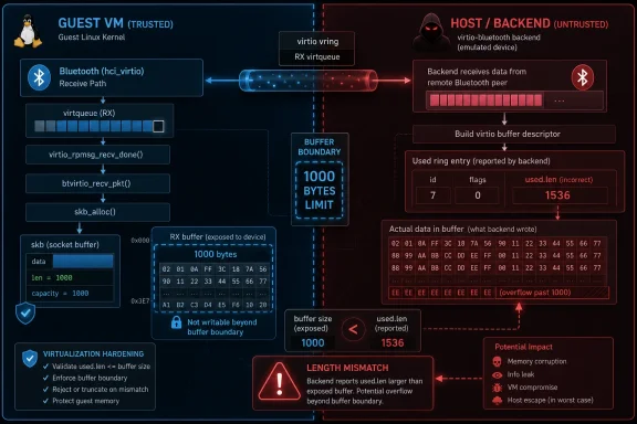

The vulnerable code path sits in virtio_bt, the Linux kernel driver that lets a guest system talk to a Bluetooth controller through the virtio device model. In the reported flaw, virtbt_rx_work() accepted a receive length returned by virtqueue_get_buf() and passed it into skb_put() without validating that the length matched the buffer size actually made available to the device.On paper, that sounds like a narrow bookkeeping bug. In kernel networking code, however, bookkeeping is security. An
skb, or socket buffer, is not merely a byte array; it is the kernel’s packet container, with pointers and length fields that tell later code what data is valid. If a driver expands an skb to include bytes the device never wrote, later processing may consume stale kernel heap contents as if they were legitimate packet data.The CVE description is unusually explicit about the mismatch. The receive buffer is exposed to virtio as exactly 1000 bytes, but checking against
skb_tailroom() is not enough because the allocated skb may have more space available than the driver actually advertised to the backend. A malicious or buggy backend can therefore claim that it filled more than 1000 bytes while still staying within the skb’s broader tailroom.That is the subtlety that turns this from “bounds check missing” into a virtualization hardening issue. The driver was not simply forgetting that buffers have limits. It was checking the wrong limit.
The Backend Is Not Supposed to Get a Vote on Kernel Memory
The patch fixes the bug by defining a singleVIRTBT_RX_BUF_SIZE constant and using that value consistently for allocation, scatter-gather setup, and receive validation. That sounds almost mundane, but it is the heart of the fix. The only trustworthy bound is the one the guest kernel itself chose when it handed a buffer to the device.The old behavior let the backend report a
used.len value above the 1000 bytes exposed through sg_init_one(). If that value was still less than or equal to skb_tailroom(), the driver could accept it and make the skb appear longer than the bytes actually written by the virtual device. The result was a packet buffer containing a mixture of real device data and uninitialized heap data.There is also a zero-length edge case. If the backend reported
len == 0, the driver could leave the skb empty and still pass it along to virtbt_rx_handle(), which reads the packet type byte from skb->data. That means even an empty completion could push the driver into consuming uninitialized memory.The fix rejects both cases: oversized completions and zero-length completions. It also uses rate-limited Bluetooth device logging so an untrusted backend cannot turn the validation path into a kernel log spammer. That last detail matters because defensive code is often reachable precisely when something hostile or broken is hammering the system.

The CVE description compares this issue to an earlier hardening change in the USB 9p transport, where unchecked device-reported lengths were also treated as dangerous. That comparison is telling. Kernel drivers have spent years learning, relearning, and institutionalizing the same rule: devices are inputs, and inputs lie.In physical hardware, a malicious device is a familiar threat model for anyone who follows USB security. A peripheral can claim capabilities, sizes, and transfer results that do not match reality. In virtualization, the same logic applies, except the device may be implemented in software, running in a host process, hypervisor component, emulator, or service stack.
Virtio is designed to be efficient and general-purpose, not magical. It provides a common framework for paravirtualized devices, but the guest driver still has to validate what comes back. If the backend says it used a buffer, the guest must verify that the reported length is plausible for the buffer that was actually posted.
That is where CVE-2026-46123 fits into the larger pattern. It is not an exotic cryptographic failure or a dramatic remote-code-execution chain. It is a failure to keep the guest’s own accounting authoritative.

Based on the public description, the clearest risk is uninitialized kernel memory consumption and potential information disclosure. Ifskb_put() extends the skb into bytes not written by the backend, subsequent code may process stale heap contents. Depending on where those bytes flow next, that can become a kernel memory leak, protocol confusion, or a crash.The zero-length path is uglier in a different way. Reading a packet type byte from an empty skb means the driver is making a control-flow decision based on uninitialized memory. Bugs like that can be hard to exploit reliably, but they are also hard to reason about safely. The kernel is not supposed to interpret whatever happened to be sitting in memory as a Bluetooth packet type.
The phrase “malicious or buggy backend” is doing important work here. Security advisories often focus on hostile actors, but in virtualization stacks, backend bugs can be just as disruptive. A bad emulator update, fuzzing harness, custom virtio implementation, or compromised host-side component could trigger behavior the guest driver was not prepared to reject.
What the public record does not yet establish is a complete exploit chain, practical privilege boundary, or real-world exploitation. That matters. The existence of uninitialized memory exposure does not automatically mean an attacker can steal secrets on demand, escape a VM, or execute code in the guest kernel. But it does mean the kernel maintainers judged the behavior unsafe enough to fix across stable trees.

The fix does not appear to introduce a new subsystem, redesign Bluetooth virtualization, or bolt on a complex mitigation. It aligns allocation size, exposed buffer size, and receive validation around one constant. That is the sort of change that looks obvious after the fact and still manages to evade review in real code.This is why kernel hardening often advances through small, surgical patches rather than sweeping rewrites. A single size constant reduces the chance that future edits will update one side of the contract but not another. A single gate before
skb_put() ensures that packet metadata cannot outrun the data actually supplied by the backend.The rate-limited error path also reflects mature defensive engineering. Rejecting bad input is necessary; rejecting it in a way that creates a denial-of-service side channel through logs is better. Kernel logging is not free, and an attacker who controls repeated malformed completions should not be given an easy way to flood storage or obscure other diagnostics.
The most important part, though, is conceptual. The patch makes the guest driver reassert ownership over its own buffer boundary. That is the right default in any driver, but it is especially critical when the “device” may be software controlled by a different trust domain.

- The bug allowed a virtio backend to report a receive length larger than the 1000-byte buffer actually exposed to it, potentially causing the guest kernel to include uninitialized heap bytes in an skb.
- The same path also accepted zero-length completions, allowing later Bluetooth receive handling to read a packet type byte from uninitialized memory.
- The upstream fix defines and reuses one receive-buffer-size constant, rejects zero-length and oversized completions, and rate-limits error logging from untrusted backend input.
