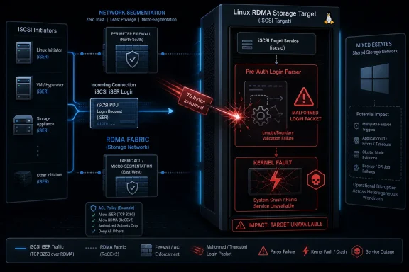

Diagram shows iSCSI/RDMA network segmentation with firewall checks, malformed login packet, and target unavailability risk.A Tiny Login Packet Becomes a Kernel-Sized Problem​

The Dangerous Part Happens Before Authentication​
The most important phrase in this vulnerability is not “integer underflow” or “memcpy.” It is before authentication. The login phase that reaches this vulnerable code path occurs before iSCSI authentication has been completed, so an attacker does not need valid storage credentials to trigger the vulnerable path.
That distinction changes the operational risk. A bug that requires authenticated access is often still serious, but it can be bounded by account hygiene, access reviews, and credential controls. A pre-authentication bug moves the first line of defense back to network reachability.
In other words, if the vulnerable target service is reachable by a hostile initiator, credentials may not save it. The security boundary becomes segmentation, filtering, exposure management, and patch state. That is a familiar pattern in infrastructure security: the most damaging bugs often do not need to break identity systems because they run before identity systems have a chance to matter.

The fix described for CVE-2026-53176 is conceptually simple: reject any login PDU shorter than ISER_HEADERS_LEN before doing the subtraction. That is the kind of bounds check developers learn early and still miss in production kernel code.

The kernel-side remediation is straightforward: reject too-short login PDUs before calculating the payload length. That prevents the negative length from existing in the first place, which is cleaner than trying to sanitize it later.
But patching the code does not answer the bigger architectural question: why can unexpected initiators reach a storage target at all? Storage protocols often assume a relatively trusted network, yet modern infrastructure repeatedly violates that assumption through flat networks, temporary lab exceptions, misconfigured VLANs, hurried cloud peering, and undocumented appliance access.

Network controls should be reviewed in parallel. The vulnerable path is reached during login, before authentication, so limiting which initiators can reach the target is a meaningful mitigation. That includes switch-level isolation, host firewalls where applicable, fabric zoning, ACLs, and any storage-network controls that restrict initiator access.
