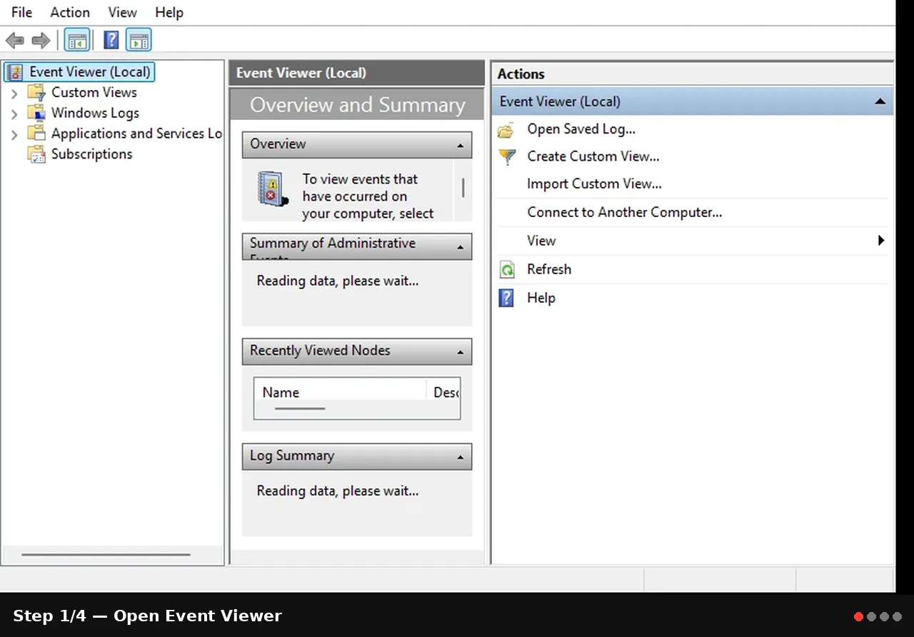

Event Viewer's Create Custom View dialog for filtering crash and startup errors by time, level, log, and event IDs.
Event Viewer with Custom Views selected in the left pane, ready to create a new custom view.
Event Viewer showing its three-pane layout with navigation on the left, event list in the middle, and details on the right.
Event Viewer open with the left navigation tree, central event list, and right Actions pane visible.
