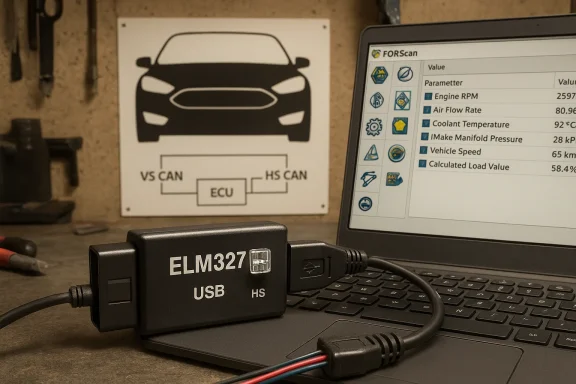

OBD-II ELM327 USB adapter connected to a laptop for car diagnostics.Background: why Ford diagnostics are different​

Anatomy of the modified ELM327 USB adapter​
Modified ELM327 adapters marketed for FORScan typically advertise the following features and claims:
  • A USB connection to a Windows laptop (stable serial/virtual COM interface).
  • ELM327 firmware version or “v1.5” on the label (a legacy designation many sellers use).
  • A physical MS‑CAN/HS‑CAN switch on the enclosure.
  • Compatibility with FORScan, ELMconfig, FoCCCus, and other Ford/Mazda tools.
  • Support for OBD2 standard protocols plus special handling for Ford MS‑CAN.
These units are cheap (often under $40) and attractive because they appear to give dealer‑level access for a fraction of the price. But this is the point where buyer beware is critical: the market is saturated with ELM327 clones and off‑brand products that only partially implement the original ELM327 command set or that use low‑quality USB serial chips. That partial implementation breaks service‑level operations FORScan depends on even if simple OBD‑II queries still work fine. FORScan itself has repeatedly warned that the majority of adapters sold under the ELM327 name are poor clones and that the project no longer recommends generic ELM327 devices for complex functions.
