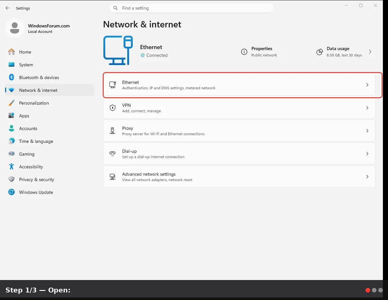

1) Confirm you’re actually connected to the right network​
  • Click Start → Settings
  • Go to Network & Internet
  • Open:
  • Wi‑Fi → (your connected network) or
  • Ethernet
  • Verify you have a valid connection and you’re not connected to a guest/captive portal network.
Windows 11 Settings on Network & internet showing connection status.
