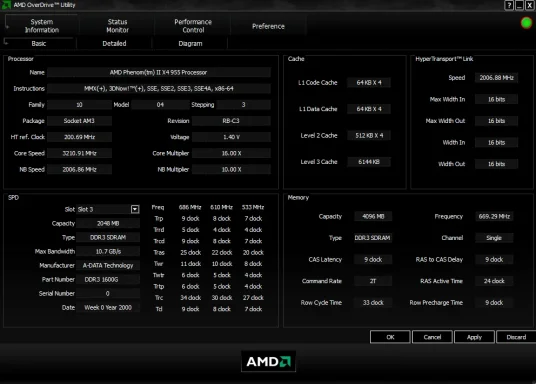

Removed admtek, updated z board, could not find newer driver for nic card. Will try test run.Any troubles pointing to vid card? Thanks for ur help.
It is 1600 11-11-11-29 now <-- the timings don't look right.
take a look at these how would u change the timings thxs

Do not use AMD overdrive, uninstall it for now and reset all clocks and voltages to their defaults, according to the manufacturer's rates.
