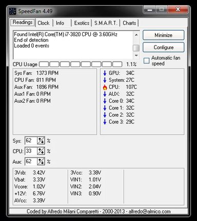

  5. teeBee
    teeBee Member
    Joined:
    Feb 22, 2014
    Messages:
    37
    Likes Received:
    2
    After 1 hour.

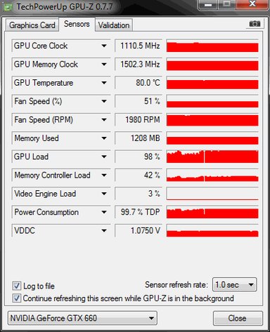

  6. GeneralHiningII
    GeneralHiningII Honorable Member
    Joined:
    Sep 21, 2012
    Messages:
    745
    Likes Received:
    7
    That 660 is running pretty hot (and it's probably overclocked) in my experience, all the ones I've seen normally run at 70 degrees 75 Celsius max. I also notice that your fan speed is only @ 50%, so try ramping that up (either in BIOS or through an overclocking tool) and see if you can get the card to cool down faster.
    Regarding the overclocking issue (which it probably is, since a reference 660 is ~950 and one from ASUS/Gigabyte is ~1000), you might want to dial it back a bit.
    It could be a thermal paste issue but I'm not sure if you have a warranty (and how long it will last for) so we can probably leave that for later (or it may not be a graphics problem at all, but one device at a time).
  7. teeBee
    teeBee Member
    Joined:
    Feb 22, 2014
    Messages:
    37
    Likes Received:
    2
    What would you suggest? I can ramp it up to 74% with ASUS GPU Tweak, but then I can hear it. Had it set to Auto before, but I guess it just didn't want to go any higher.
    Using ASUS GPU Tweak I cant get it to go any lower than 1110.
    EDIT: The EXACT card (Apparently, news to me).
    #27 teeBee, Feb 27, 2014
  8. GeneralHiningII
    Joined:
    Sep 21, 2012
    Messages:
    745
    Likes Received:
    7
    MSI Afterburner is what I personally use to both overclock and set fan speeds.
    You say you can hear it after 74%, but unless it's producing an absolutely unbearable sound, you should push it higher at a constant speed and try playing the game again to see if it changes anything.
  9. teeBee
    teeBee Member
    Joined:
    Feb 22, 2014
    Messages:
    37
    Likes Received:
    2
    After 1 hour.
  10. kemical
    kemical Windows Forum Admin
    Staff Member Premium Supporter Microsoft MVP
    Joined:
    Aug 28, 2007
    Messages:
    32,089
    Likes Received:
    1,598
    Hi,
    actually 66c is pretty cool for a GPU which can run happily (the latest chips) at around 80c. MSI afterburner on the other hand is known in bsod circles for being a cause of bsod's under win 7. Try removing the actual app to test.
    Check for malware using this app as it's one of the best at search and destroy:
    https://www.malwarebytes.org/
    If you have a recent dump file please post.

    Here's a new one, or an old one, they all might just be pointing to the same thing now.
    No luck with finding someone to test the GPU, nor could I find a spare computer that might support it. I've been running FurMark tests for a few minutes (40), gonna try for 2 hours later today. The temps are still as usual.

    Also to note, this.
  18. kemical
    Joined:
    Aug 28, 2007
    Messages:
    32,089
    Likes Received:
    1,598
    That's way too high! Try replacing either your current cooler or the thermal paste.
  19. teeBee
    teeBee Member
    Joined:
    Feb 22, 2014
    Messages:
    37
    Likes Received:
    2
    Exactly. However, Core Temp never showed up any problems, and SpeedFan was initially on this computer some time ago and it showed no problems either. Now, to also note, this is the temperature straight after loading into windows. That's baaaaaaaad, or SpeedFan is reading it wrong.
    EDIT: Also, wouldn't my computer force itself off due to overheating?

    Code:
    *                        Bugcheck Analysis                                    *
    Use !analyze -v to get detailed debugging information.
    BugCheck 9F, {3, fffffa8008016060, fffff80003c073d8, fffffa800b154320}
    *** WARNING: Unable to verify timestamp for nvlddmkm.sys
    *** ERROR: Module load completed but symbols could not be loaded for nvlddmkm.sys
    Probably caused by : nvlddmkm.sys
    Followup: MachineOwner
    If that temp is showing as soon as you boot into windows then as you say it's probably speedfan that's out of kilter. As you can see Nvidia driver is still showing as the culprit. Have you considered more on trying a re-install?
