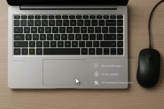

A non-responsive HP Pavilion 15 trackpad usually points to a small set of causes rather than a dead laptop: a disabled touchpad hotkey, a driver hiccup, a Windows setting, or a genuine hardware fault. The good news is that the most common fixes are simple, and several of them can be done entirely from the keyboard if the cursor is frozen. The bad news is that touchpad failures can feel intermittent, which makes them look more mysterious than they really are.
Top-down view of a laptop with Device Manager, driver update, and HP Hardware Diagnostics panels on screen.Background​
HP Pavilion notebooks, including many Pavilion 15 variants, have relied on a mix of firmware toggles, Windows input settings, and vendor-specific drivers for years. That means the trackpad can stop responding for reasons that have nothing to do with the touchpad hardware itself. In practice, a disabled gesture, a bad sleep-state resume, or a corrupted Synaptics, ELAN, or HID driver can make the device look dead even when the panel is physically fine.
