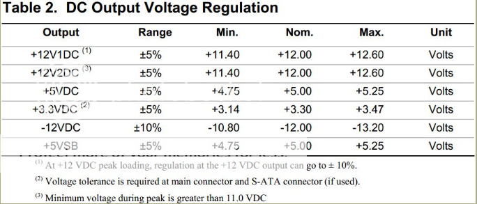

Note the required voltage tolerance ranges:

Note that minor fluctuations in the DC readings are normal, but they still must remain within the required specifications and they typically vary because the load is constantly varying. And that's fine. But SpeedFan and ALL other software based monitors do NOT measure ripple - which is unwanted AC riding the DC voltage, and a very real anomaly that can wreck havoc on digital electronics.
