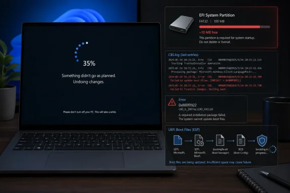

The Update Failed Where Users Cannot See
The important detail is not that another Windows update failed. That happens often enough that many users have developed a grim ritual around Patch Tuesday: install, reboot, wait, watch the percentage crawl, hope the machine returns intact. The important detail is where this one failed.The EFI System Partition, or ESP, is not the C: drive. It is not the place where users save downloads, games, Teams recordings, or forgotten ISO files. It is the small FAT-formatted boot partition used by UEFI systems to store boot files and related firmware-facing components, usually hidden from File Explorer and insulated from normal cleanup tools.
That means the user-facing symptom is misleading. Someone can have hundreds of gigabytes free on their Windows volume and still hit an update failure because the boot partition has run out of usable space. Windows Update then looks broken, but the underlying dispute is between servicing code and a partition that was designed to be small, quiet, and boring.
The May update apparently needed to touch boot-related files and perform a space check. On affected machines, that check found too little room, particularly where 10MB or less remained free on the ESP. The installation had already progressed far enough to require a reboot, which is why the rollback appears late in the process rather than as an up-front warning before the user commits to downtime.

The ESP Was Supposed to Be Boring
The EFI System Partition is one of those pieces of PC infrastructure that works best when nobody discusses it. On a modern GPT-formatted disk, it sits near the front of the drive and holds files that firmware uses to start Windows. It can also accumulate OEM utilities, boot managers, diagnostics, recovery components, and leftovers from multi-boot experiments.That history matters. Many PCs ship with layouts created by OEM imaging systems, not by a pristine Microsoft lab install. Some vendors add files under their own directories. Some users later install Linux, third-party encryption tools, boot managers, or firmware update utilities. Some machines have been upgraded across multiple Windows generations without ever revisiting whether their hidden partitions still make sense.
A few megabytes may sound trivial in 2026, but the ESP lives in a different economy from the rest of the disk. A 100MB or 260MB boot partition can be perfectly adequate for years, then suddenly become a constraint when a servicing operation needs temporary room, padding, or new boot files. Windows may own the update, but it does not always own the partition history.
That is why the “10MB free” threshold is so revealing. Microsoft is not saying every ESP smaller than a given size is broken. It is saying this specific update path can fail when the free space margin is extremely thin. The immediate fix may be small, but the broader lesson is that hidden system partitions are now part of the Windows reliability surface.

The Patch That Turned 10MB Into a Trust Issue
The practical story is narrow, but the trust story is broad. KB5089549 can fail on Windows 11 24H2 and 25H2 systems with very low free space on the EFI System Partition, and Microsoft has mitigations in motion. The bigger issue is that Windows still too often transforms low-level maintenance assumptions into user-facing uncertainty.- The affected update is the May 2026 Windows 11 security update KB5089549 for Windows 11 versions 24H2 and 25H2.
- The failure is associated with error 0x800f0922 and often appears during reboot servicing at roughly 35–36 percent.
- The specific trigger is limited free space on the EFI System Partition, especially when the partition has about 10MB or less available.
- Microsoft’s consumer mitigation is Known Issue Rollback, which should propagate automatically to consumer and unmanaged business devices, with a restart helping it apply sooner.
- Enterprise-managed devices may need administrators to deploy and configure the special Known Issue Rollback Group Policy.
- Users should avoid manually deleting files from the EFI System Partition unless they have a verified backup and know exactly what they are changing.
