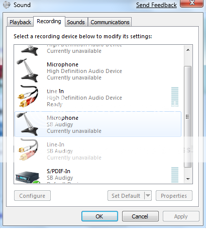

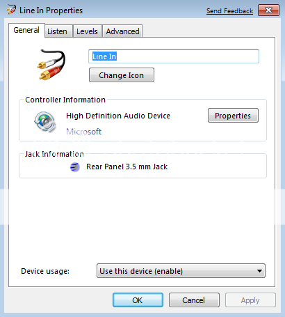

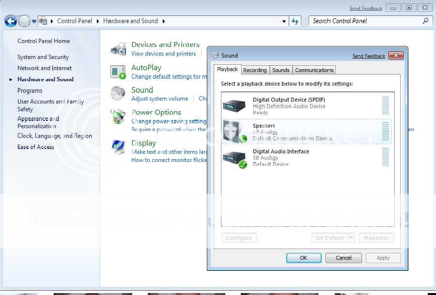

    i took some screens of my settings maybe you can see whats wrong better this way
    says its working here
    [​IMG]
    then the settings
    [​IMG]
    more settings
    [​IMG]
    you can see the top is just another microphone thats unavailable
    i tried to get that and the one on the bottom so you could see them all
    [​IMG]

    If the DM is showing after you used the drivers from Creative, I must say the updated driver is OK and it is corroborated by Windows Control Panel > Sound Properies. showing those audio devices but no hardware connected.
