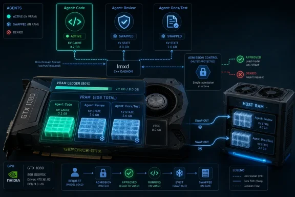

Its policy is almost embarrassingly simple: cap usable VRAM at a configured percentage, estimate the new model’s cost, and admit it only if the ledger says the total stays under budget. The article uses a 90 percent cap, which leaves headroom for runtime overhead, driver behavior, and the usual messiness that makes exact GPU memory accounting harder than spreadsheet arithmetic.
The important part is not the number. It is the order. lmxd looks up the estimate, reserves against the ledger, and only then loads the model. If the ledger refuses, the model is never loaded and the GPU is never touched.
That sounds obvious until you compare it with the naive path. If the program loads first and accounts later, it has already performed the riskiest operation before deciding whether the operation was permitted. That is how systems become unrecoverable under pressure: the check exists, but it happens after the damage.
That mutex is not decorative. Without it, two agents registering at nearly the same time could both observe the same available headroom and both conclude they fit. By the time either updates the total, the system has already promised more VRAM than it intends to allow.

The daemon, lmxd, is deliberately unglamorous. It sits between agents and llama.cpp, listens over a small Unix-socket protocol, and decides whether a model should be admitted before any expensive load happens. In a field addicted to novelty, that restraint is the point.Its policy is almost embarrassingly simple: cap usable VRAM at a configured percentage, estimate the new model’s cost, and admit it only if the ledger says the total stays under budget. The article uses a 90 percent cap, which leaves headroom for runtime overhead, driver behavior, and the usual messiness that makes exact GPU memory accounting harder than spreadsheet arithmetic.
The Mutex Is the Difference Between a Policy and a Wish
The ledger’s core reservation routine is short enough to look trivial, which is usually a sign that the design has been pushed to the right place. It takes a lock, verifies initialization, checks for integer overflow, calculates the projected allocation, compares it with the maximum, and commits the new total only if the request fits.That mutex is not decorative. Without it, two agents registering at nearly the same time could both observe the same available headroom and both conclude they fit. By the time either updates the total, the system has already promised more VRAM than it intends to allow.

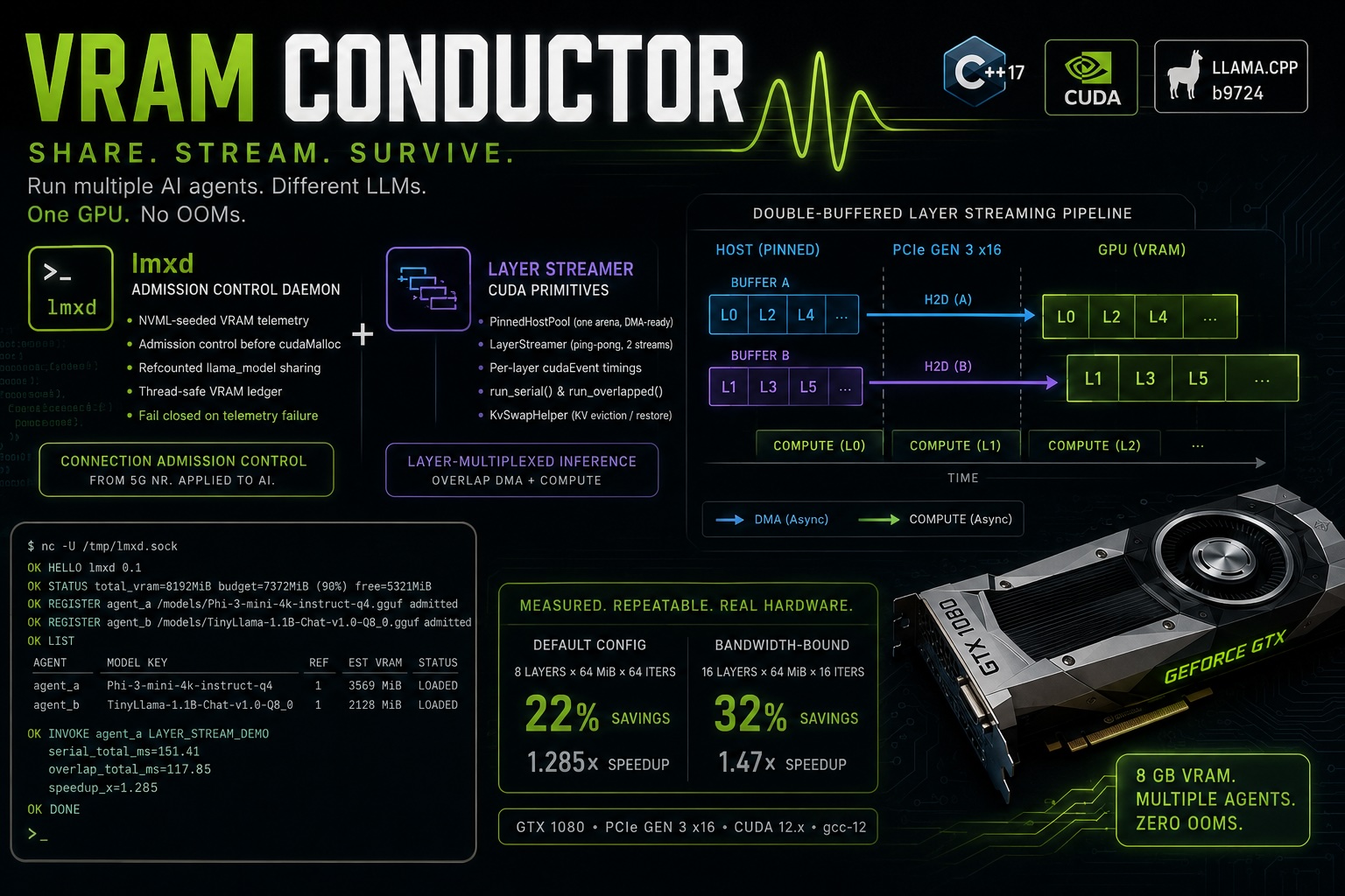

The second half of lmxd’s admission story is consolidation. Instead of launching three independent binaries, the daemon initializes the llama backend once and keeps a refcounted map of loaded models. If two agents ask for the same GGUF, the daemon reuses the loaded model and increments a reference count.That matters because process overhead is not free. Multiple CUDA tenants bring their own contexts, allocator behavior, and driver-side costs. On a large workstation GPU, that may be lost in the noise. On an 8GB GTX 1080, the noise is the budget.

There is a subtle but important distinction in the article: lmxd admits multiple agents, but it does not make all of them compute simultaneously on the GPU. Only one live llama context is active at a time. The others are registered, known, and resumable, but their KV state is pushed to host memory when they are not the current tenant.That is not a weakness so much as an honest definition of the product. On a tiny old GPU, pretending to run several decoding workloads truly concurrently may be less useful than ensuring several agents can take turns without crashing. For many local agent workflows, that is already the difference between a demo and a usable tool.
The daemon exposes this through a
DECODE verb. When a request arrives for a different agent, the context manager evicts the currently active agent’s state, frees its GPU context, builds or restores the requested one, and runs the decode. The response reports whether KV was evicted and whether a prior state was restored.Those wire-level details are not cosmetic. They turn the memory choreography into something operators can inspect. If an agent resumes successfully after its KV state was restored from host memory, the user knows it was suspended rather than killed.
Swapping KV to Host RAM Is the Price of Survival
The KV swap design is the article’s most pragmatic move. Suspended agents pay in system RAM, not VRAM. That is slower than keeping every context resident on the card, but it is also the only reason multiple agents can coexist under the constraint that only one live context fits comfortably.This is the right trade for a poor machine. The GTX 1080 is not being asked to behave like a modern data-center accelerator. It is being asked to provide continuity across multiple agents without letting any one of them permanently monopolize the card.

Layer Streaming Points Toward the Harder Future
The article does not stop at admission and KV swapping. It also sketches a more ambitious direction: stream model layers from pinned host memory into VRAM as needed, overlapping transfer for layer N+1 with compute for layer N. That is the classic double-buffered pipeline idea applied to local LLM inference on constrained hardware.The intuition is sound. A transformer decode step touches layers sequentially. If the whole model cannot remain resident, the runtime might still keep only the active layer or next few layers in VRAM while the rest wait in host memory. With page-locked host allocation, two device buffers, two CUDA streams, and events for timing, transfers and compute can overlap.
The article’s demo uses a representative FMA sweep rather than a real llama.cpp transformer layer. That distinction matters. Proving that asynchronous copy and synthetic compute overlap on a GTX 1080 is not the same as integrating streamed quantized matmul into llama.cpp’s graph execution.
