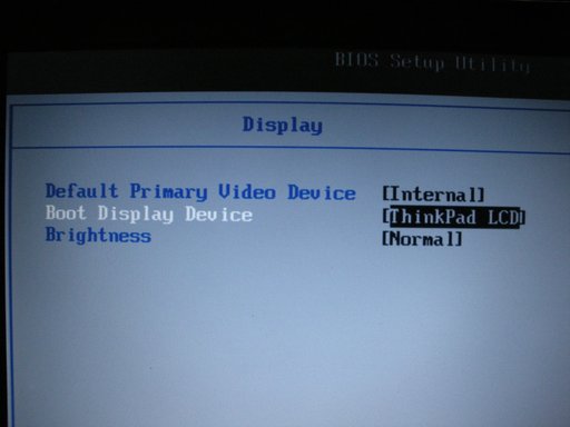

    Here are a few screen shots of the BIOS options ! Note: for the HDD there is AHCI and compatibility ONLY (current setting is Compatibility) . Now, for the Display options in BIOS, i am confused as to the correct setting,,,,,i provided 2 screen shots with the options available ! Hope they will help !

    I am still a little confused. The SATA options you show as "compatibility" with no other options shown, are not related to the Display options you show in the other attachments.

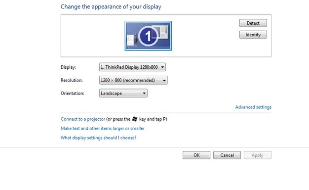

    You have the Thinkpad display shown, so you should be seeing a normal display if you have a driver for the onboard video. If you right click on the desktop and select screen resolution, what resolution are you showing?

    I never said the four screens provided are related ! I made sure that was clear ! however, all i asked was,,,"what are the correct settings for this type of laptop" ? Please stop confusing yourself !
