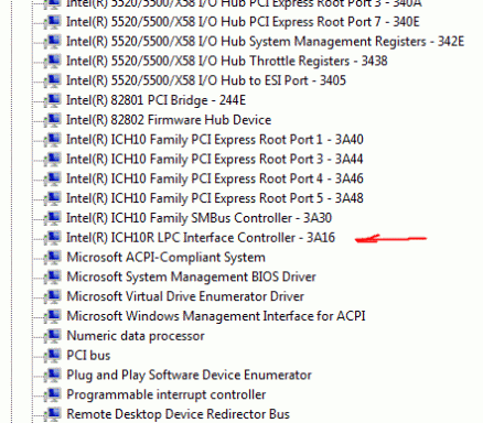

The driver for mine, which is a 3A16 shows it uses the machine.inf file for setup info and the msisadrv.sys is the driver.
It seems to be related to the ACPI system and should be under the System Devices heading in Device Manager.
Whenever I load the Intel Chipset drivers, which I do, it goes through this process where you can watch it being installed. You may want to run it as admin to see if it completes if it has not yet done so.
I have attached a picture of part of my System Devices entries so you can see where it should go and how the other entries might look. You should be showing specific chipset entries if the Intel Driver has been installed correctly.

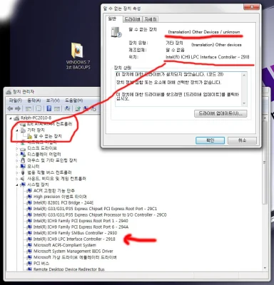

Please see picture ,
I have the "Intel(R) ICH9 LPC Interface Controller - 2918" both in the System section , aswell
as in the "unknown Device" section ... When I right click and properties the unknown device
a mention of "Intel(R) ICH9 LPC Interface Controller - 2918" is given as a description.
I have no clue what to do with this now ...
