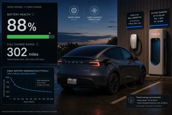

The stronger data point here is Tesla’s built-in battery health procedure, which requires the vehicle to be plugged into a Level 2 charger while it discharges the pack deeply and charges back to full. That process is meant to give the battery-management system a clearer look at usable capacity. It is not something most owners will run casually, and the reported 12-hour duration underlines that this is closer to a diagnostic event than a dashboard glance.
Even so, “88% battery health” is not the same as “this car has lost exactly 12% of every useful mile it will ever deliver.” Battery health estimates are model-driven. They are attempts to infer a complex electrochemical reality from voltage, current, temperature, charge throughput, and behavior across a pack made of many cells. The number is meaningful, but it is still an estimate.

That is where this Model Y becomes interesting. According to the report, about 43% of its charging came from Level 2 AC charging at home, while 57% came from DC fast charging. That is a high DC share for a privately owned low-mileage vehicle, though the owner reportedly noted that not all of it was peak-rate Supercharging; some was slower 50 kW DC charging.
The distinction matters. A 250 kW Supercharger session is not the same stress event as a 50 kW DC charge, and Tesla’s battery-management system actively controls charging speed based on temperature, state of charge, and pack condition. Still, DC charging tends to involve higher pack currents and more heat-management work than home AC charging. Over time, that can become part of the degradation story, especially when paired with other stressors.
The mileage number also leaves out parked energy use. Flasch reportedly keeps Sentry Mode and Cabin Overheat Protection active while the car sits outside. Those features can draw meaningful energy, especially in warm weather. The odometer may barely move, but the battery is still working.
But Sentry Mode consumes power. The same is true of Cabin Overheat Protection, which can run fans and air conditioning to keep the cabin from reaching extreme temperatures. Tesla does not hide the fact that these features use energy, but the psychological effect is different when the car is parked. Owners may perceive the vehicle as idle when, electrically, it is not.

If Flasch’s Model Y went from 100% to 88% in 18 months, a straight-line projection would be alarming. It would suggest the pack could approach the low 80s by the end of a three-year lease. But batteries do not necessarily age like tires, shedding capacity in neat, linear increments with every month or mile.
The report notes that Davide Giacobbe of EV battery testing company Voltest described a pattern in which much of the degradation happens earlier, with the rate often slowing once a pack reaches around 90% health. That fits a common EV-owner experience: a noticeable early drop, then a long plateau. It does not guarantee this particular Model Y will stabilize, but it argues against extrapolating the first 18 months into the next six years.
That nuance is crucial because the internet loves curves that point down and to the right. A single owner’s data can become a morality play about an entire technology. The more accurate conclusion is narrower and more useful: this car’s early health result is worse than many buyers would expect, and its future trajectory now matters more than its past mileage.
The next test, not the current one, may be the revealing moment. If the pack stabilizes near 88%, the story becomes one of unpleasant but bounded early loss. If it continues dropping rapidly, it becomes a stronger case for service escalation, deeper diagnostics, or at least a clearer explanation from Tesla.

The Numbers Owners Should Remember From This Tesla
The useful response is not panic, but better literacy. This case gives owners and fleet managers a compact set of numbers to keep in mind when judging their own vehicles.- The reported Model Y had 13,162 miles and 18 months of use when Tesla’s built-in test showed 88% battery health.
- The car reportedly displayed 302 miles at a full charge, down 36 miles from its original displayed range when new.
- Earlier tests reportedly showed about 95% health around 6,000 miles and about 90% around 11,000 miles.
- About 57% of the car’s charging reportedly came from DC fast charging, while about 43% came from Level 2 AC charging.
- Parked features such as Sentry Mode and Cabin Overheat Protection may consume enough energy to make mileage a poor proxy for total battery workload.
- Tesla’s warranty threshold is far lower than this result, so an owner can experience disappointing degradation without necessarily having a warranty claim.
