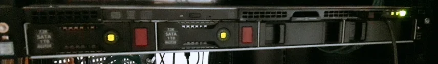

A charity where I volunteer has an HPE ProLiant DL60 Gen9 Server. It is equipped with 2 hard drives 1TB SATA configured in raid 1.
Raid: HPE Dynamic Smart Array B140i RAID Controller
The installed operating system is Windows Server 2012 R2. When the server starts up, I come across the screen "Troubleshoot". By clicking on "Refresh your PC", I end up with the following message: "The drive where windows is installed is locked. unlock the drive and try again"
I used diskpart to check if it sees the disks and it shows me the following message: "There are no fixed disks to show"
All LEDs on the server and hard drives do not indicate any problems as described in the user guide.
Drive status : Solid green. The drive is a member of one or more logical drives.
I tried a repair with Lazesoft, but he can't see the hard drives. Same with the Synology backup tool which does not see the disks.
