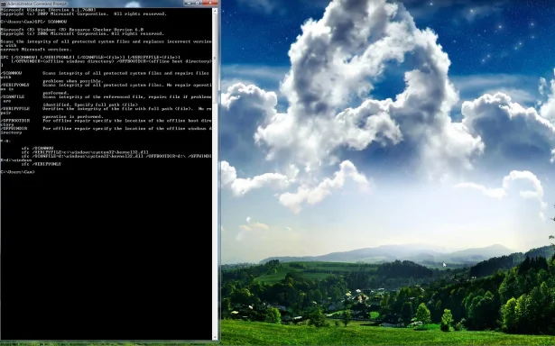

How long should the system integrity checker run for? I don't think it ran properly because it only lasted a second. I took a screen shot and here's what the results were.
Thanks
Thanks
Hello,
Ya you typed it wrong its SFC /SCANNOW - After SFC a space then slash SCANNOW !!
