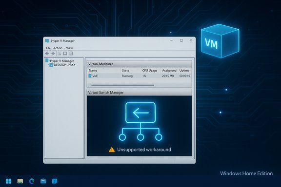

Hyper-V Manager on Windows shows an “Unsupported workaround” alert in Virtual Switch Manager.Background / Overview​
