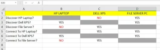

Ok, the issue I have at the moment is that the HP Laptop cannot see the File Server on the network and also wont connect to the file server if I type in the address in manually i.e. //NETSTOREPC/, but I can see and successfully connect to the OfficeJet Pro printer and the Dell XPS desktop.
The Dell XPS can see the File Server and both Printers, but it cannot see my HP Laptop, but the difference with this problem is I can connect to the HP laptop successfully if I type in its destination address, //HPLAPTOP/.
Now to confuse you even more! The file server see's everything on the network, and it can connect to everything without any problems.
This whole setup I have has worked for months, nothing has been changed. All of a sudden one day my network became broke and I have tried everything I can think of to restore it all back to working order.
Anyone have any suggestions I could try?
Much Appreciated
danwfs
New Member
In case this makes my post clearer! I know this all points to the HP Laptop, its pretty obvious but I'm not sure whats causing it
