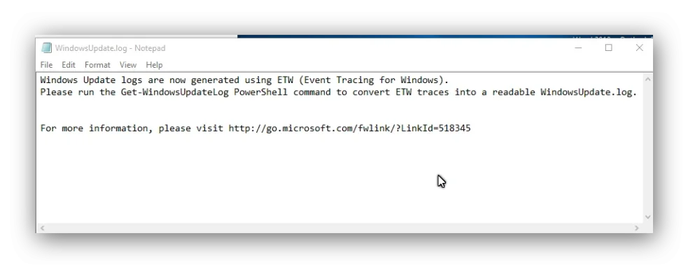

Can you upload your Windows Update log. C:\Windows\WindowsUpdate.log
TerryLP
Active Member
Aug 15, 2015
56

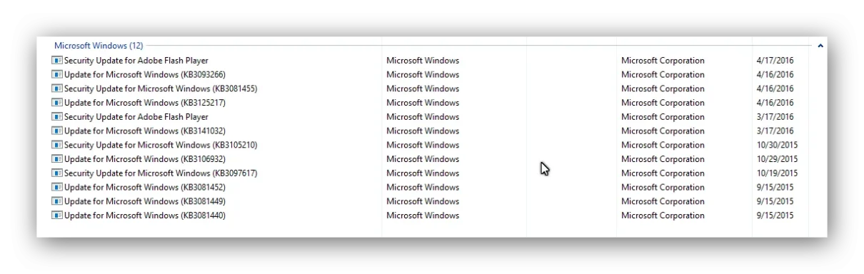

I went to the C:\Windows\WindowsUpdate.log. I made a screen capture of it. I also made a list from the updates in the Control Panel. [ATTACH type="full" align="right" alt="An image from 'Updates Failing then looping and rebooting'. 1. Windows Update logs now use ETW and require PowerShell conversion.
2. List of Microsoft Windows security and system updates with dates and KB numbers."]32279[/ATTACH] [ATTACH type="full" align="right" alt="An image from 'Updates Failing then looping and rebooting'. 1. Windows Update logs now use ETW and require PowerShell conversion.
2. List of Microsoft Windows security and system updates with dates and KB numbers."]32280[/ATTACH]
