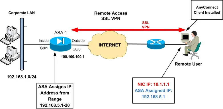

Here are a couple of simple VPN network diagrams to give you an idea of what I'm looking for and they will help you with the conceptual aspects as well; CLICK ON ATTACHED THUMBNAILS BELOW TO VIEW IMAGES:
Note the device labels and IP addresses in these diagrams. This is what we're looking for on your equipment at your end and at the other end of your VPN tunnel connection!
