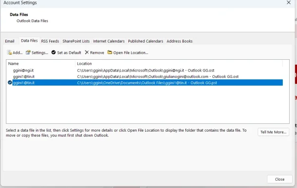

ok I create the folder in my C: directory just by clicking right and select new folder on my win11 desktop? i have difficulty in finding the Onedrive folder?
112,394
Yes — you can create the folder on C:, but it’s easiest to do it from File Explorer (so you are sure it’s really on C: and not on Desktop/OneDrive).
Also: in your screenshot you already found the OneDrive folder path. Your PST is here:
C:\Users\ggini\OneDrive\Documents\Outlook Files\[email][email protected][/email] - Outlook GG.pst
That OneDrive location is exactly why you keep seeing “This file is in use”.

In the same Outlook window you showed (Account Settings → Data Files):
  1. Click the line with the .pst (the one that ends with Outlook GG.pst)
  2. Click the button Open File Location…
That will open the exact folder where the PST is stored (your OneDrive folder).

D) Tell Outlook to use the PST in the new location​
  1. Open Outlook
  2. File → Account Settings → Account Settings → Data Files
  3. Click Add… → select:
    C:\Outlook Files\[email][email protected][/email] - Outlook GG.pst
  4. Select the old PST entry that points to OneDrive → click Remove (this removes it from Outlook; it doesn’t delete the file unless you delete it manually)

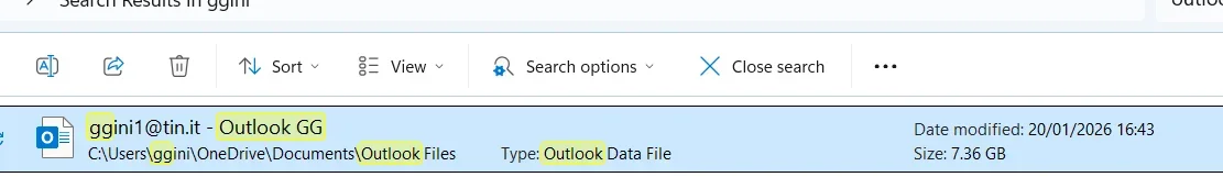

I found this folder is it the correct one to act? to transfer
112,394
Yes — that is the correct file and current location (it’s your PST), and it’s currently inside OneDrive:
C:\Users\ggini\OneDrive\Documents\Outlook Files\[email][email protected][/email] - Outlook GG.pst (7.36 GB)
That’s the one we want to move out of OneDrive to stop the “file is in use” warning.

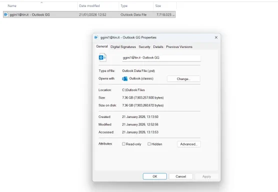

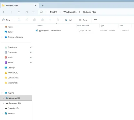

Ok i have created the new folder in C; outlook files.
I have copy the second file from OneDrive as you can see the screenshot shows two files i have copy the second one in my new Outlook Folder but it took just a few seconds? is it normal

Yes, it can be normal for it to finish in a few seconds if:
  • your PC has a fast SSD, and
  • the file was already stored locally on C: (your OneDrive folder is also on C:), and/or
  • Windows used cache.
However, because it’s a 7.36 GB PST, we should verify that it really copied the full file (and not just a OneDrive “placeholder”).
1) Verify the copy is real (30 seconds)​
In C:\Outlook Files\:
  1. Right‑click [email][email protected][/email] - Outlook GGProperties
  2. Check Size and Size on disk
    • It should be around 7.36 GB (similar to the OneDrive one).
  3. Also check the file is not showing a cloud icon (it shouldn’t, because it’s not in OneDrive).
If the size is tiny (MB or KB), then it likely copied only a placeholder—tell me what “Size” shows.
Quick extra check (optional)​
Open File Explorer, click View → Show → File name extensions and confirm the file ends with .pst.
2) If the size matches: switch Outlook to the new PST​
Now do this:
  1. Open Outlook
  2. Go to File → Account Settings → Account Settings → Data Files
  3. Click Add…
  4. Select: C:\Outlook Files\[email][email protected][/email] - Outlook GG.pst
  5. Then select the old OneDrive PST entry (C:\Users\ggini\OneDrive\Documents\Outlook Files\...pst) and click Remove
This stops Outlook from using the OneDrive PST.

112,394
No need to apologize — your screenshot actually confirms everything is correct.
Why you “can’t see .pst”​
Windows is currently hiding known file extensions, so it shows the file as:
…but in Properties it clearly says:
Type of file: Outlook Data File (.pst)
and the size is 7.36 GB at location C:\Outlook Files.
So the copy is real and complete. Good.
Next: stop OneDrive warning (final steps)​
1) Add this new PST in Outlook and remove the OneDrive one​
  1. Open Outlook (Classic)
  3. Click Add…
  4. Select:
  5. Now click the OLD one that points to OneDrive:
  6. Click Remove
  7. Close Outlook and open it again.
(This prevents Outlook from continuing to use the PST inside OneDrive.

112,394
That screenshot looks perfect now.
  • Your PST is now here (good): C:\Outlook Files\[email][email protected][/email] - Outlook GG.pst
  • The other two entries ending in .ost under C:\Users\ggini\AppData\Local\Microsoft\Outlook\... are normal for IMAP/Exchange accounts and should not be moved.
What to do next (quick test)​
