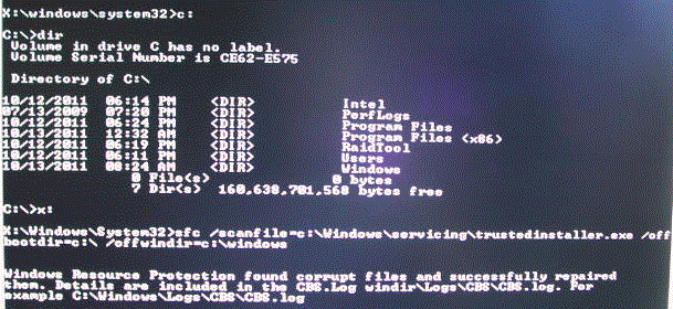

I just reinstalled the file by using the offline version SFC. But this may not work if more files were missing than just the one .exe file.
The biggest requirement here is to make sure you know the drive letter of your Windows partition while in the Recovery Environment.
