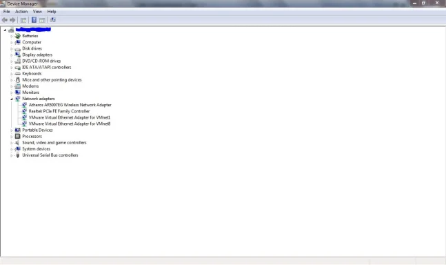

Can you post a screenshot of the device manager with the network adapters section maximized?
You can type snippingtool.exe in the start menu then hit enter to get a program that takes screenshots. Use the paperclip above where you type to attach the .jpg.
Did you uninstall or update VMWare yet?

#8
I didn't reinstall VMWare yet as I haven't had any problems with it since the BSOD.

Here is the latest Atheros driver offered by Toshiba:
http://cdgenp01.csd.toshiba.com/content/support/downloads/driver_wifi_atheros_TC00190600E.exe
I would also install this latest modem driver to update the ones you have now:
http://cdgenp01.csd.toshiba.com/content/support/downloads/driver_modem_toshiba_TC00221500C.exe
The Realtek driver that Toshiba is offering is much older than what you have now, so stick with that.
The reason I asked if you uninstalled or updated VMWare is because you have previously gotten bsod because of it and you still complain of slow shutdown. Updating has excellent chance of fixing this.
