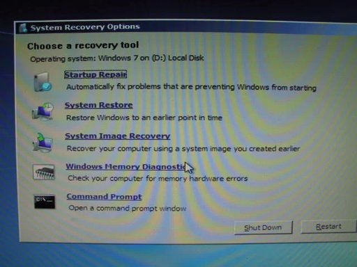

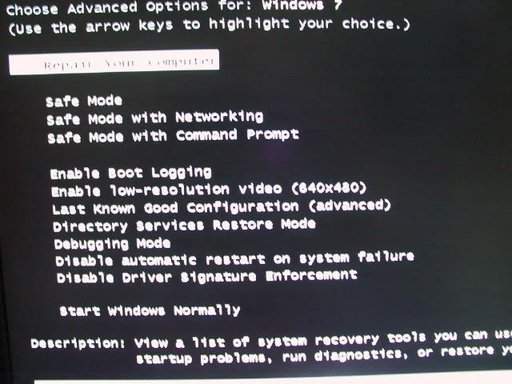

#5
It helps us if you explain in precise terms what you have tried and failed. For instance, if you hit F8 during boot, are you able to get the boot options screen and select safe mode or Repair your computer. Check the attachments, the first one is the F8 window and the next one is what you get when you select "Repair Your Computer".
Let us know what options you have.

#6
F8 takes me to advanced boot options but my pc will not start safemode it does the same thing as Starting Windows normally flashing the blue screen and then restarting. Repair your Computer takes me to loading files then that green loading thing then a black screen with a cursor and just stops there. I've tried enable low resolution, last known good configuration, and disable driver signature enforcement. I just want windows to work again. I can afford to lose any files I have. I'm not worried about programs as I can just reinstall them. So, if reinstalling windows 7 will work then thats an option. So, is it possible to use someone's installation dvd? Can I reinstall and will that fix the issue? I'm not worried about losing files and programs as my pc is mostly used for internet and entertainment.
