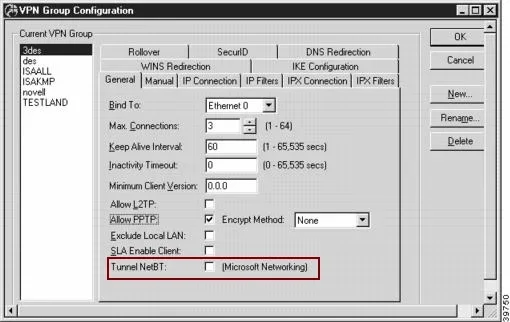

In order to use a VPN to tunnel NetBIOS your VPN client software needs to support and be configured to do so.
I've attached an example from a Cisco VPN client configured as such.
Tunnel NetBT
If this box is checked, all traffic using Microsoft's networking protocol, Windows NetBT, will be tunneled.
Source: http://www.cisco.com/en/US/docs/security/vpn5000/manager/reference/guide/client.html#wp1019931
Additionally, generally speaking the LMHosts file, rather than the Hosts File is used to aid and support the propagation and resolution of NetBIOS names to IP addresses across routed networks so you may have some luck editing LMHosts instead of Hosts.
The LMHOSTS file must contain a NetBIOS name–to–IP address mapping for all computers that are not on the local network subnet.
Source: http://technet.microsoft.com/en-us/library/cc959903.aspx
