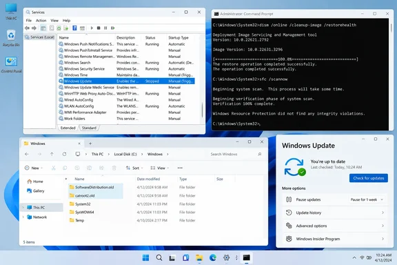

Windows desktop shows Services, Command Prompt, File Explorer, and Windows Update windows.Windows Update service wuauserv: confirm the failure before repairing it​

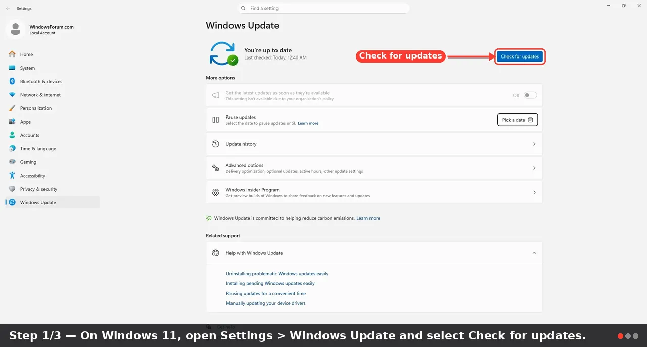

Start by restarting the PC once. That sounds basic, but it separates a service temporarily held by an update installation from a persistent configuration problem. After the restart, open Settings and try a manual check for updates:
  • On Windows 11, open Settings > Windows Update and select Check for updates.
  • On Windows 10, open Settings > Update & Security > Windows Update and select Check for updates.
If the check fails or Windows Update is visibly unavailable, inspect the service directly.

A quick command-line check is useful because it makes the difference explicit. Open Command Prompt as administrator and run:
sc query wuauserv
If Windows returns service status information, wuauserv is registered. A stopped service will report a stopped state; that is a configuration or operational problem, not proof that the service is missing.
If the command reports that the specified service does not exist, Windows cannot find the registered service entry. Do not assume that a cache reset will fix that condition. The update cache is separate from the service registration Windows uses to launch wuauserv.

Open Command Prompt as administrator, then run these commands one at a time:
Code:
net stop bits
net stop wuauserv
ren %systemroot%\softwaredistribution softwaredistribution.bak
ren %systemroot%\system32\catroot2 catroot2.bak
net start bits
net start wuauserv
BITS is the Background Intelligent Transfer Service, which Windows Update can use for background transfer work. SoftwareDistribution is a working area that includes downloaded update files and local update metadata. catroot2 stores catalog-related data used by the servicing process. Renaming both folders forces Windows to build clean replacements after the services restart.
DISM.exe /Online /Cleanup-Image /RestoreHealth
The /Online switch targets the Windows installation currently running on the computer. /RestoreHealth tells DISM to scan and repair component-store corruption. The process can take several minutes or longer and may appear to pause at a percentage for some time. Leave the command window open until it reports a final result.
On a normally connected consumer PC, DISM can use Windows Update as a repair source. This creates an important limitation in a “Windows Update is missing” case: if the PC cannot reach the update service at all, DISM may be unable to retrieve what it needs. Microsoft documents that an alternate repair source can be supplied in managed or offline scenarios, but that source must match the affected Windows installation closely enough to provide valid component files. A random Windows folder copied from another PC is not a dependable substitute.
If DISM reports that the restore operation completed successfully, run:
sfc /scannow
Wait until verification reaches 100 percent. Then restart the PC and test Windows Update again.
