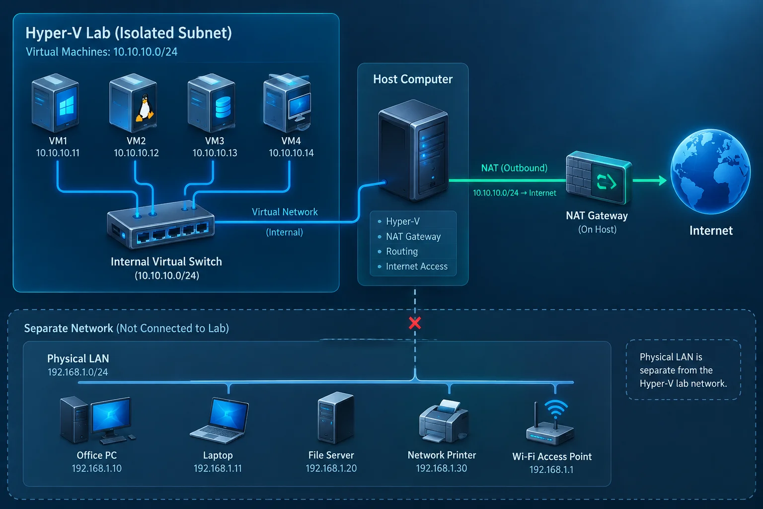

A Hyper-V NAT network is one of the cleanest ways to give lab virtual machines internet access without handing them a seat on the same physical LAN as every other device in the building. The important distinction: NAT is not a special Hyper-V switch type. The working arrangement is an Internal virtual switch, an IP address assigned to the host-side virtual adapter, and a Windows NAT object that translates guest traffic through the host’s connection. It is a tidy little network border—less red carpet, more bouncer at the door.
This setup is ideal for testing software, building a Windows 11 lab, running an isolated Linux appliance, or experimenting with server roles without making each VM directly visible on the home or office network. Guest VMs can reach the internet through the host, communicate with the host and other VMs on the same internal switch, but do not receive an address from the physical LAN’s DHCP server.
Diagram showing an isolated Hyper-V lab subnet with outbound NAT internet access, separate from the physical LAN. Before You Start​
