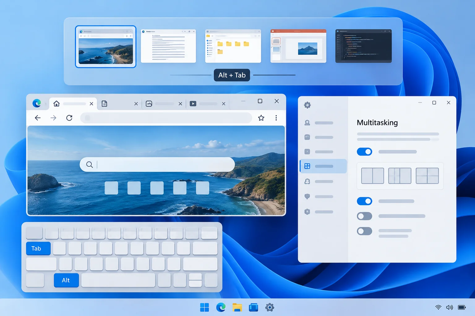

A Windows desktop illustration shows Alt+Tab app switching, a browser, multitasking settings, and a keyboard highlighting Alt and Tab. The quick fix: change the Multitasking setting​
  • Press Windows + I to open Settings.
  • Select System.
  • Select Multitasking.
  • Find the Alt+Tab setting:
  • On many Windows 11 installations, it is labeled Show tabs from apps when snapping or pressing Alt+Tab.
  • On Windows 10, and on some earlier Windows 11 builds, look for Pressing Alt + Tab shows.
  • Choose Don’t show tabs or Open windows only.
The exact wording varies by Windows version, but the desired result is the same: Alt+Tab should show application windows, not separate Edge tabs.
Now open an Edge window with several tabs and press Alt + Tab. You should see one Edge thumbnail for that browser window rather than a stack of individual webpages.
