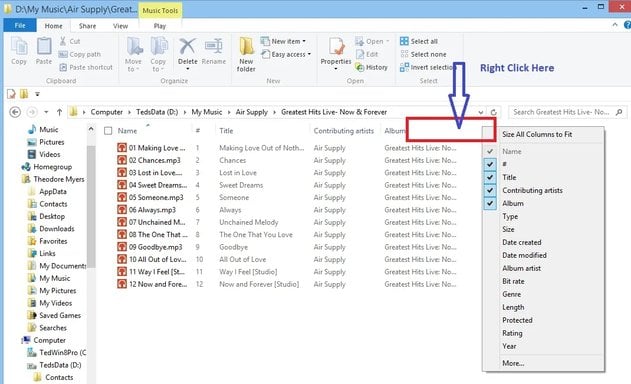

If you right click the blank area to the right of the title bar you get many options.
Link Removed
I just want to clarify that the columns are visible, this is not the problem.
Please see screenshot. In the column with a red square is where I'd expect to see the tag properties, as the files in question DEFINITELY have tags.
Link Removed
