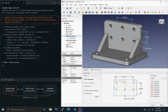

FreeCAD shows a redesigned mounting bracket with a 2×3 hole pattern and exported STEP/STL files.FreeCAD remains the system doing the engineering work​
The setup described by MakeUseOf relies on the open-source FreeCAD MCP project from developer neka-nat. MCP, or Model Context Protocol, is the connector that gives a model access to external tools. In this case, Claude can create and edit FreeCAD documents and objects, execute Python inside FreeCAD, obtain object details, capture a view, and run certain analyses.
FreeCAD is still responsible for building the actual parametric model: sketches, constraints, pads, booleans, fillets, bodies, and exports. That distinction is practical, not semantic. A generated .FCStd project can remain editable in FreeCAD after Claude’s session ends, which is far preferable to a black-box mesh generated by an AI service. FreeCAD’s current stable 1.1.1 release also follows the project’s work on more resilient parametric references, a relevant improvement when a model is repeatedly altered by scripts.
The real shift is that Claude Code can turn a plain-language request into a sequence of FreeCAD Python operations, observe a failure or incomplete result, and revise the sequence. A request such as “make a 120 mm by 80 mm mounting plate with four M4 clearance holes 10 mm from each corner” maps cleanly to dimensions, repeats, and simple constraints. Such work is often tedious precisely because it is routine.

The main FreeCAD MCP project explicitly documents Claude Desktop support. Its tool list includes creating, editing, deleting, inspecting, and listing FreeCAD objects, obtaining screenshots, and executing arbitrary Python in FreeCAD. In other words, Claude Desktop with the same MCP server already has the basic ability to issue a CAD operation, receive a tool result, and issue another operation. The server’s own demonstration material is built around Claude Desktop control.
Claude Code may be a much more convenient environment for the author’s repeated error-handling loop, particularly when FreeCAD scripts and project files live alongside the ongoing session. But it is not accurate to attribute the entire capability to Claude Code alone. The important ingredient is an MCP-connected CAD application with a tool-capable agent, while Claude Code adds persistence, filesystem context, command-line management, and a development-oriented interaction model.
There is another unverified detail in the report. The FreeCAD MCP project’s public tool inventory does not list a dedicated command for reading FreeCAD’s Report View. It does expose execute_code, which can run Python in the application, and other inspection tools that can give Claude useful feedback. The author may indeed have built a working feedback loop, but the claim that Claude Code directly reads the Report View should be understood as a description of that individual configuration, not as a documented stock feature of FreeCAD MCP.
That is still enough to change the workflow. Most CAD users do not need a model to understand design intent in the abstract; they need it to notice a failed boolean, modify a radius or placement, and regenerate the model without making the human become the courier for every error string.
