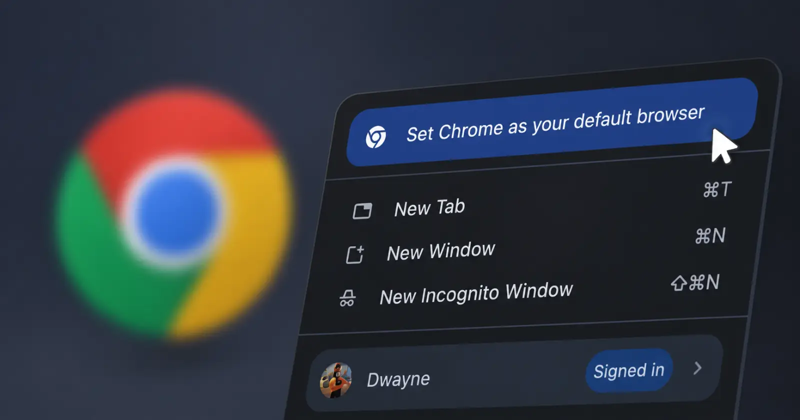

Windows Report frames Edge as the second major Windows browser testing this approach, after Google Chrome. That comparison is essential because it prevents the story from collapsing into the simplistic claim that only Microsoft wants to make default-browser switching easier for itself. Chrome, according to earlier coverage, is also working on a visual walkthrough to help Windows users set Chrome as their default browser.
BrowserReported statusWalkthrough goalPage or entry point named in source materialWindows Settings behaviorCaveat
Microsoft EdgeTesting in pre-release versions of EdgeHelp users set Edge as defaultedge://default-browserResizes Windows Settings to display alongside instructions, with Edge already selected and an arrow to Set defaultUnfinished, under active development, not confirmed or final
Google ChromeWorking on a similar featureMake it easier for Windows users to set Chrome as defaultChrome’s hidden default-browser walkthroughVisual walkthrough approach reportedly resembles Edge’s testRollout details not confirmed in the provided reporting
The same design pattern looks different depending on who deploys it. When Chrome builds a visual guide, it is a dominant browser trying to overcome Windows friction. When Edge builds a visual guide, it is Microsoft’s browser taking advantage of deep familiarity with the platform it ships on.
That does not automatically make the Edge version abusive. Microsoft’s Windows app defaults guidance explicitly allows apps to direct users to Settings and to guide them through the process with prompts or documentation. The same guidance also says developers should prompt thoughtfully, provide clear instructions, and respect user choice. The debate, then, is not whether guidance is permitted; it is when guidance becomes pressure.
Chrome’s version gives Microsoft cover. If Google can create a walkthrough that points users through Windows Settings, Microsoft can plausibly argue that Edge deserves the same right as any other browser. The counterargument is that Edge is not situated like any other browser, because Windows already gives it privileged distribution, system integration, and default status on fresh installations.
