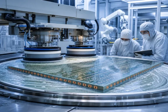

Cleanroom technicians oversee robotic machinery processing a large semiconductor wafer.CMP is the process glass packaging cannot simply skip​
Chemical-mechanical polishing, or CMP, combines abrasive slurry with a polishing pad and controlled pressure to remove material evenly and leave a highly planar surface. It is a mature step in silicon wafer fabrication, but applying it to large glass panels used in advanced packaging is a different manufacturing problem.
Absolics is developing glass-core package substrates that use through-glass vias, or TGVs: microscopic passages drilled through the glass and filled with copper to connect circuitry on opposite sides. After copper plating, excess metal and topographical variation remain across the panel. Wet etching can remove some unwanted copper, but it is less suited to bringing copper and glass to a tightly controlled common height over a large area.
For fine redistribution layers — the dense copper wiring that routes signals among chiplets and other components in a package — surface variation is a yield risk. A substrate that is not sufficiently flat can complicate subsequent lithography, metal deposition, dielectric coating, and bonding steps. CMP is therefore not a cosmetic finishing operation; it is a process intended to make later high-density interconnect steps repeatable.
