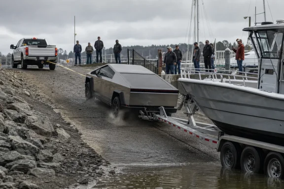

The TikTok footage described in the reports shows a Cybertruck attached to a sizable gray boat trailer on an uneven, concrete-and-gravel incline. For the first several seconds, the truck appears to make measured progress. It pulls the trailer forward slowly while onlookers watch from the boat and surrounding area.
Then momentum disappears.
The reporting says the Cybertruck stops moving forward roughly eight seconds into the attempt. After an edit, it is visibly moving again—but the conclusion is not a heroic recovery by the EV’s traction control. A second conventional pickup is connected ahead of the Cybertruck and pulls the disabled combination uphill. The original AOL report describes that assisting vehicle as a Ram, while the AOL Canada version identifies it as a Ford F-150. That discrepancy is worth flagging, because the clip’s central fact is clear while the precise make and model of the recovery truck is less consistently reported.
The important visual is not the badge of the rescue vehicle. It is the recovery configuration: the second truck appears to be doing the work of pulling both the boat and the Cybertruck up the incline.
For social media, this is devastatingly simple. The Cybertruck, a product designed around unconventional styling and bold utility claims, is presented as the trailer’s middleman rather than its tow vehicle. The accompanying comment culture practically writes itself, and the video’s popularity reflects how closely the scene collides with popular expectations about what a pickup truck should do.

The incident shows that this particular Cybertruck, with this particular boat trailer, on this particular uneven incline, did not complete the ascent unaided. It also shows another pickup being used to help move the Cybertruck-and-boat combination uphill, according to both supplied reports. AOL and AOL Canada agree on the essential sequence.
It further shows why towing capability must be judged in context. Buyers who tow boats do not operate only on level, dry, grippy pavement. They encounter wet ramps, uneven marina access roads, gravel, changing loads, and traction problems that cannot be captured by a single brochure statistic.
What it does not show
The clip does not establish the boat’s verified weight. It does not establish whether the trailer was within the Cybertruck’s rating, whether the load met tongue-weight guidance, whether the truck was operating in Trailer Mode, whether the trailer brakes were configured correctly, or whether tire choice and pressure were appropriate.
It also does not establish that the Cybertruck lacks enough motor power to tow the boat. The visible issue appears more consistent with a loss of effective traction or an inability to sustain forward motion under the combined load and surface conditions. Those are serious practical limitations in their own right, but they are not synonymous with “not enough horsepower.”
Finally, the video does not demonstrate a hitch or frame failure. The separate controversy surrounding high-load hitch stress tests should be evaluated on its own evidence and with attention to the difference between vertical loading, shock loading, rated tongue weight, and rated trailer mass.
