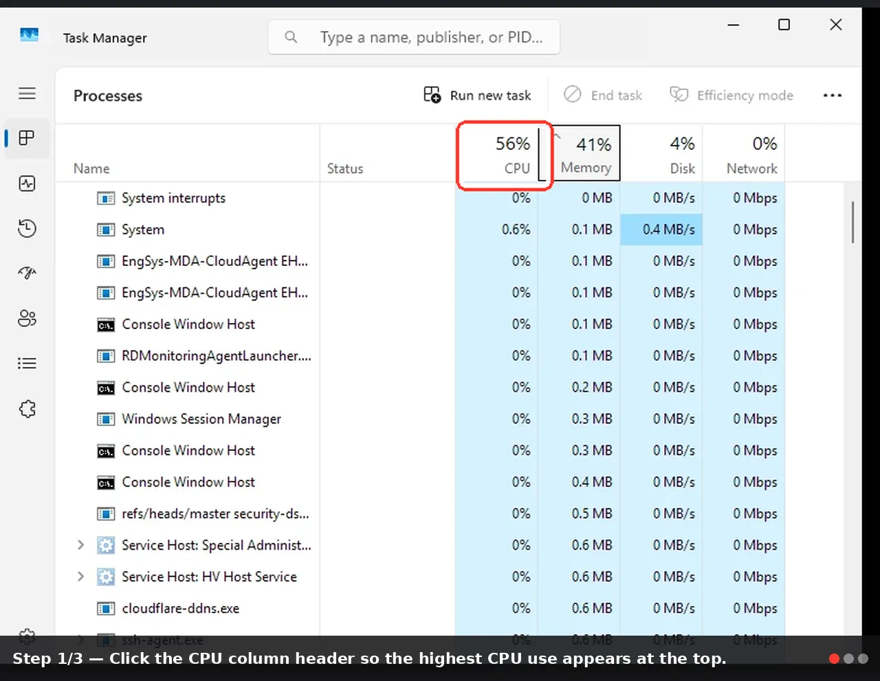

  3. Check for an unexpectedly busy process:
    • Press Ctrl + Shift + Esc to open Task Manager.
    • In Windows 11, select Processes in the left navigation if it is not already selected.
    • In Windows 10, select the Processes tab.
    • Click the CPU column header so the highest CPU use appears at the top.
  4. Note any application consistently using substantial CPU while you are doing nothing. Common examples include a web browser with many tabs, a game launcher updating in the background, cloud-sync software, video-export software, antivirus scans, or an app that has stopped responding.
