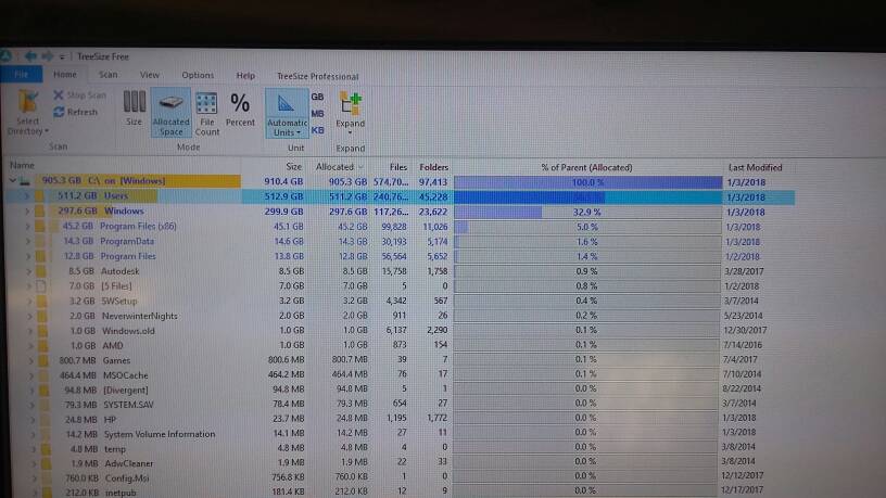

You can use something like TreeSize to figure out what is using up the space. I'd suggest posting your top 10 offenders before deleting anything though. TreeSize Free - Quickly Scan Directory Sizes and Find Space Hogs
Just did treesize and here is a screen shot. Im wondering if it was a windows update because i have not added nor downloaded anything or installed anything.. maybe spyware or virus Users has 511gb and windows has 297. Program fils has 45

Can you expand Windows and show the top offenders there it should definitely not be that large.

Procmon shows its taking up 268.6 gb under windows tab Sent from my SM-S920L using Tapatalk

I think you enabled boot logging in procmon and never re-launched procmon to finish.

I did enable bootlogging but i did restart program, unless my laptop restarted by itself at night and i done did disnt restart procmon. Ok, how to clear that? Sent from my SM-S920L using Tapatalk

The process for a boot log capture is
  • Enable boot logging in procmon
  • Reboot
  • Launch procmon (let it collect all the logs)
If you already did that, launch procmon and make sure boot logging is not checked, close procmon then just delete that .pmb file
