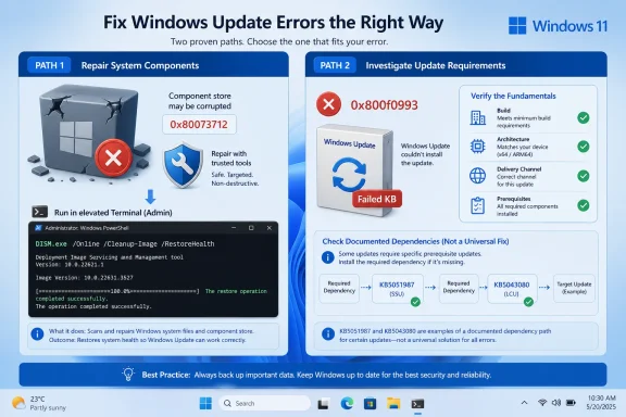

Error 0x80073712 Calls for DISM Repair​
Microsoft identifies 0x80073712 as ERROR_SXS_COMPONENT_STORE_CORRUPT. This is the stronger diagnostic mapping of the two errors discussed here and supports beginning with Windows image repair.
Open an elevated command environment:
  1. Right-click Start.
  2. Select Terminal (Admin).
  3. Approve the User Account Control prompt.
Run the exact command:
DISM.exe /Online /Cleanup-Image /RestoreHealth
Allow DISM to finish. Its progress can remain at the same percentage for an extended period, so a temporarily stationary progress indicator does not by itself mean the process has stopped.
If DISM reports that the operation completed successfully, use System File Checker as the next validation and repair step:
sfc /scannow
In this playbook, DISM comes first because 0x80073712 points to component-store corruption. SFC then checks protected system files after the component-store repair has completed.
Restart the PC and retry the failed update once. That controlled retry establishes whether the repair changed the result. If the same update fails again with the same code, confirm the DISM result and move toward the supported repair-reinstall path rather than performing an uncontrolled sequence of unrelated fixes.

Error 0x800f0993 Is an Update-Specific Investigation Trigger​
There is no sound basis for translating every occurrence of 0x800f0993 into either “the component store is corrupt” or “install KB5043080.”
The precise documented example is narrower: a manual installation of KB5051987 involved prerequisite KB5043080. That case establishes the need to inspect the requirements for the exact update being installed.
It does not establish that:
  • Every 0x800f0993 failure has the same cause
  • KB5043080 is a permanent fix for the error code
  • The code always means a checkpoint update is missing
  • DISM should be run without separate evidence of corruption
  • A package required by one update should be installed for a different update
  • A manual-install solution applies to a failure delivered through Windows Update or an organization’s management platform
Start in Settings > Windows Update > Update history and identify the failed KB. Then record the Windows version, OS build, architecture, and installation channel.
Check Microsoft’s support information for that exact update. If Microsoft documents a checkpoint or prerequisite package, follow the documented sequence and confirm that every package applies to the installed release and architecture.
If no prerequisite is documented, the branch must end with a controlled escalation rather than an open-ended search for packages:

Checkpoint Cumulative Updates Matter During Manual 24H2 Installation​
Windows 11 24H2 introduced checkpoint cumulative updates. A later cumulative update can therefore have a documented dependency on an earlier checkpoint package.
This matters most when a user or administrator is installing an update manually. Before using a package from the Microsoft Update Catalog, check the support information for the target KB and verify any stated prerequisites.
The KB5051987 and KB5043080 relationship is useful as a concrete example of the kind of dependency that can exist. It is not a reusable two-KB recipe.
Before a manual installation, verify:
  1. The exact target KB
  2. The installed Windows version and OS build
  3. The device architecture
  4. Whether Microsoft documents a prerequisite or checkpoint update
  5. Whether that prerequisite is already installed
  6. Whether manual installation is the intended delivery method
  7. Whether the PC is controlled through an organization’s servicing system
If the documentation for the failed update does not identify KB5043080 or another prerequisite, do not install one solely because a different case used it.

What should I do if no prerequisite is documented for 0x800f0993?​
Retry the update once through its intended channel. If it fails again, collect the failed KB, Windows build, architecture, error code, and delivery channel.
Send those details to the organization’s administrator on a managed device. On an unmanaged PC, continue with Microsoft-supported Windows Update troubleshooting or support rather than installing speculative prerequisite packages.
Why do checkpoint cumulative updates matter?​
Windows 11 24H2 checkpoint cumulative updates can create a documented dependency between a later cumulative update and an earlier checkpoint package. This makes prerequisite verification important during manual installation.
It does not mean every 24H2 update requires the same checkpoint package.
Should I run DISM or SFC first?​
For 0x80073712, run DISM first because Microsoft maps that error to component-store corruption:
If DISM completes successfully, follow with:
sfc /scannow
This sequence repairs the component store first and then checks protected system files.
Where is the Windows Update troubleshooter?​
Open the Get Help app and search for the Windows Update troubleshooter. A troubleshooting option may also appear under:
Settings > System > Troubleshoot > Other troubleshooters
Use the automated troubleshooter for failures delivered through Windows Update, then continue with the targeted error-code path if the problem remains.
Will Fix problems using Windows Update remove my applications?​
Microsoft describes the repair-reinstall capability as reinstalling the current Windows version while preserving applications, personal files, and settings. It is distinct from Reset this PC.
Where can I find the repair-reinstall option?​
Check Settings > System > Recovery for Fix problems using Windows Update or a similarly labeled repair option. The wording and availability can vary, so use the recovery options presented by the installed Windows build rather than relying on an assumed identical interface.
Why might the repair-reinstall option be missing?​
Its absence does not establish one particular cause. The options displayed can depend on the Windows build, device configuration, and administrative control. On a managed PC, contact the administrator. Otherwise, consult Microsoft-supported recovery guidance for the installed release.
Should I manually install an MSU on a work-managed computer?​
Not without authorization from the organization’s administrator. Record the failed KB, error code, build, time, and delivery channel first. A manual package can interfere with the managed servicing process or make the original deployment failure harder to investigate.
Is clearing the Windows Update cache the best first step?​
Not for these errors. For 0x80073712, start with DISM. For 0x800f0993, identify the failed KB and check its documented requirements.
Use cache maintenance only when there is a defined update-state or download problem that makes it relevant.
