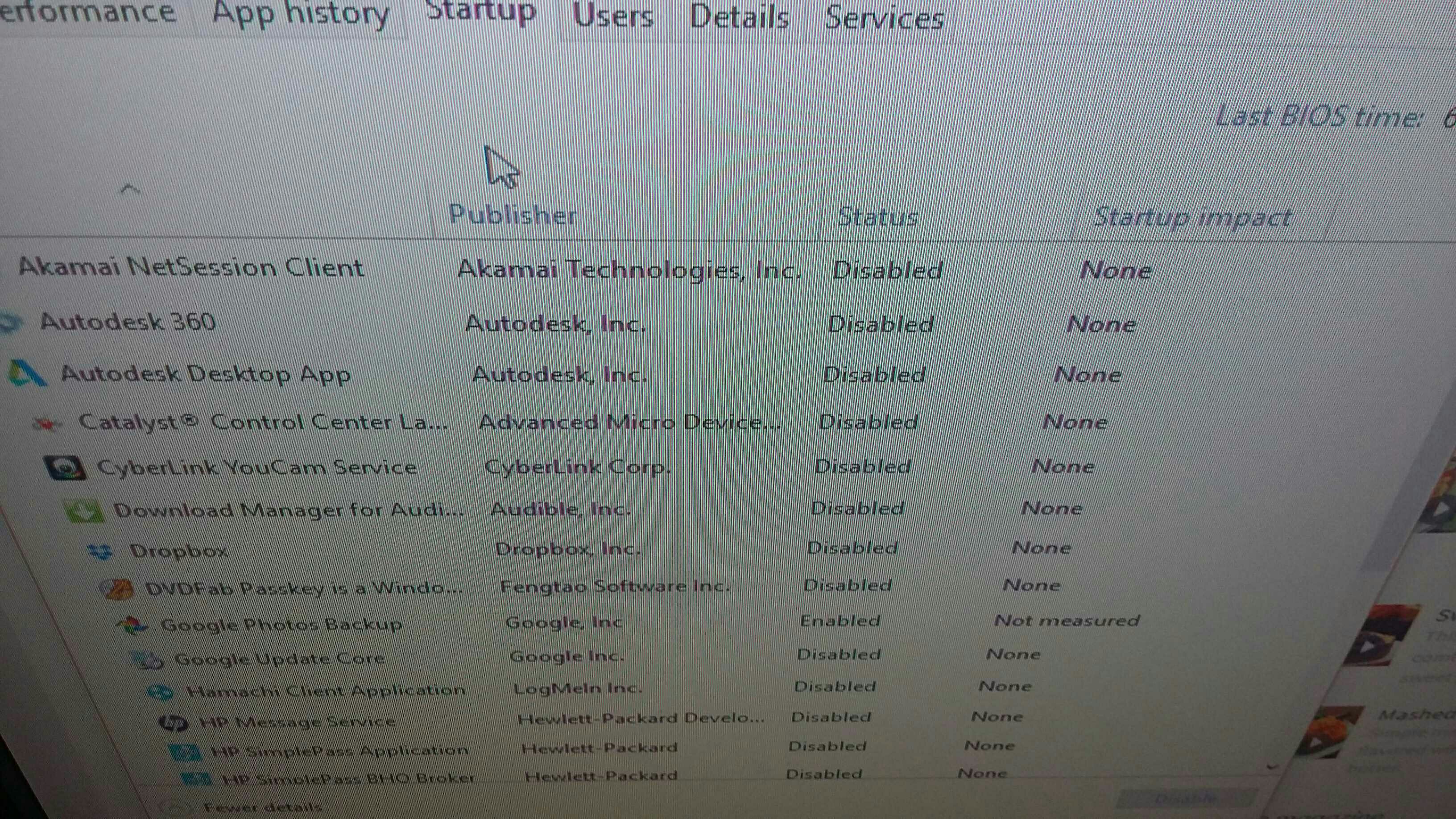

Ok i finished the sans and no errors or anything. Did the restore health as well. Here is a poc of my task bar. Oh and i did a spybot scan and update Dont mind the slope fields on the second image. Thanks

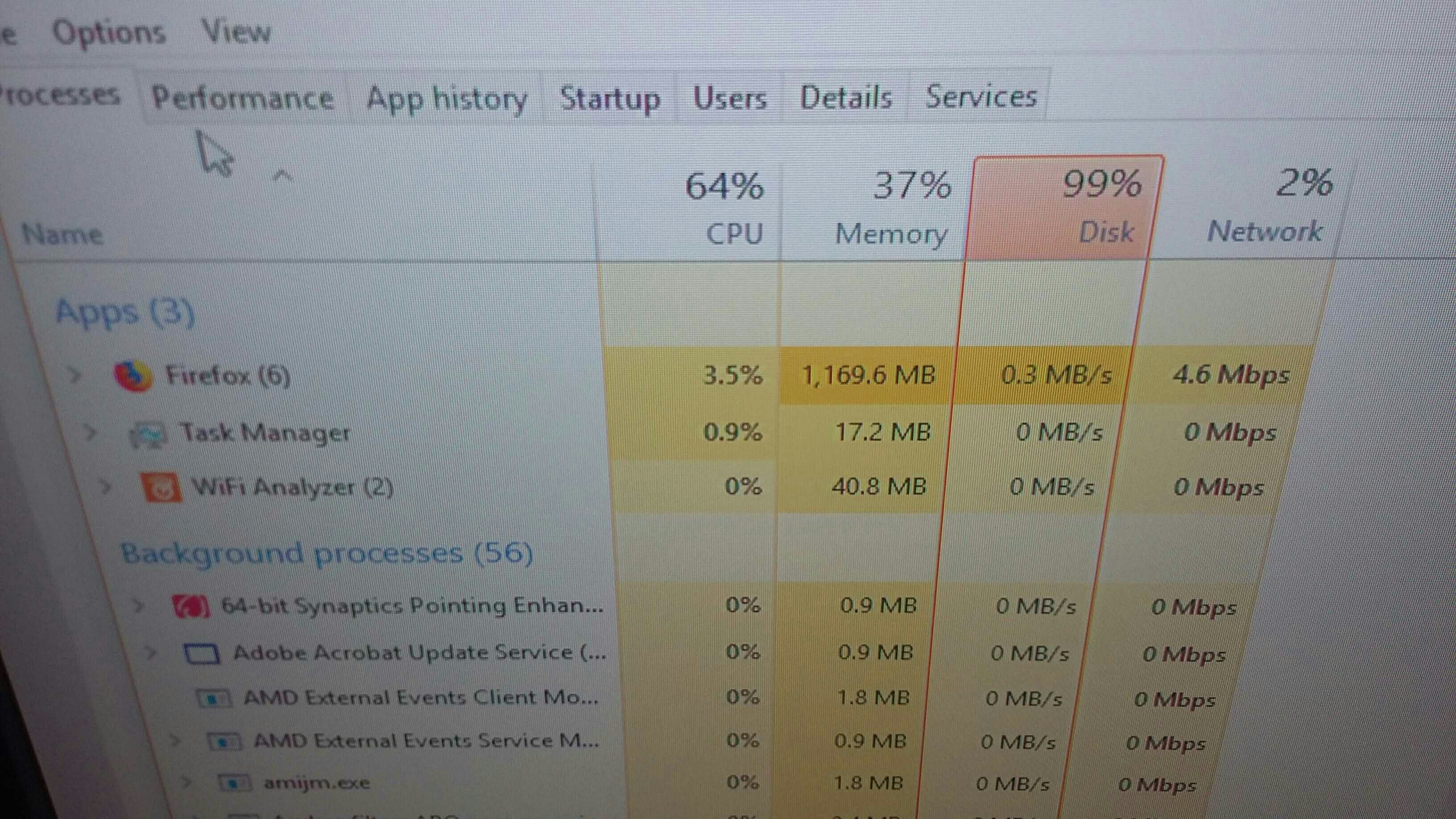

99% disk is bad.... but i jave plenty of space haha Sent from my SM-S920L using Tapatalk
No extensions.. ill try tha app you sugestef Sent from my SM-S920L using Tapatalk
You sorted the Task manager view on Name, please click on 'Disk' (top of 4th column) to see what really eats up your disk. And it may be or may not be the cause of your slow booting problem.
And let it go for say half an hour, it may be some system task, like reordering, malware check, which needs to compleet.

Thats what i forgot was the boot logs. Im just confused to see why it says disk is 99% full when in "this pc" the drive reports like 75% full Ill look at the disk option again and sort by usage, not name. Haha Thanks guys Sent from my SM-S920L using Tapatalk
Thats Disk I/O, it doesn't have to do with disk space.
Ohh, that makes s3nse. However, when i sorted by size today, the largest one was firefox at 1.03mb and then the other 4 were below 0.5mb and then the rest were 0. It still seems odd to have it at 99% with only firefox usin 1.0x mb haha Sent from my SM-S920L using Tapatalk
I believe task manager only shows a processes main thread so you won't see all the IO on a per process basis.

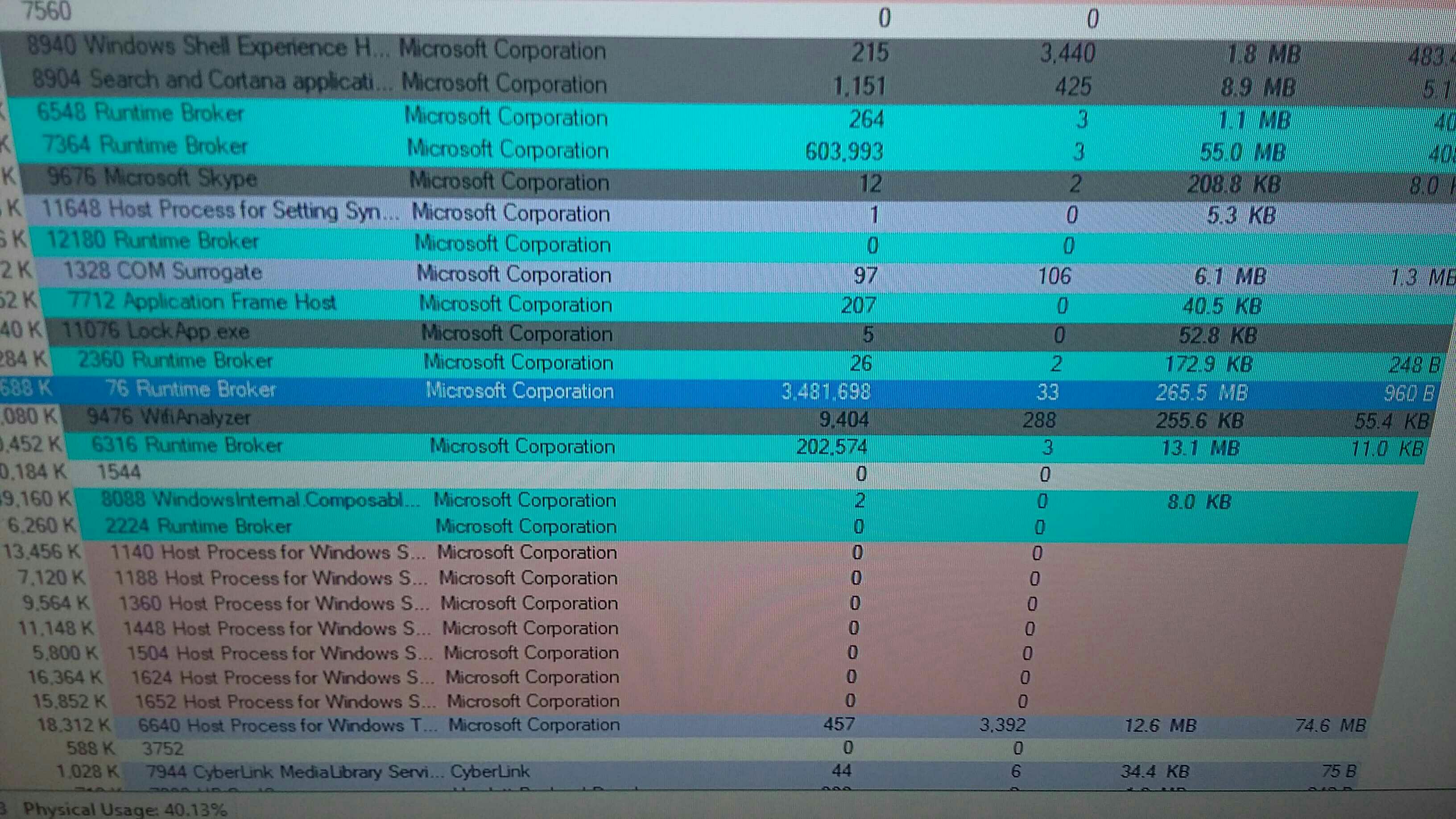

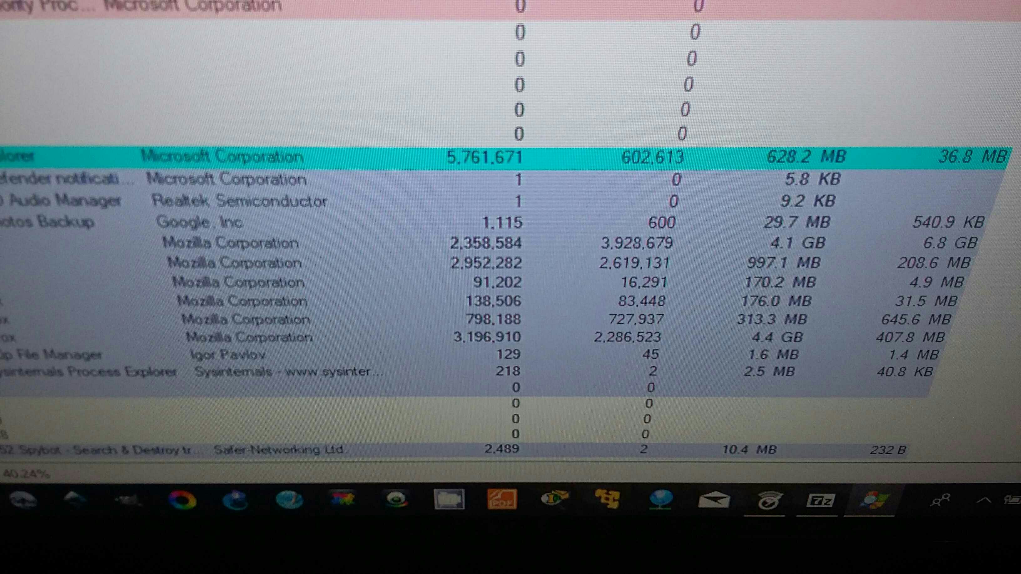

Basically something is making your hardrive 'thrash' or run at 100%, as Neemobeer say's this issue isn't to do with how full the C drive is but it's actual usage. This little guide will help you determine what the probable cause is (or send the details in to us and we'll have a look for you) How to detect what process is thrashing your hard drive
Which details would you like:) oh and also how does one check the boot log again to see what is taking so long? Thanks for every thing. Merry christmas and happy holidays. Sent from my SM-S920L using Tapatalk
Ok, here is output from process explorer for io reads,iowrites etc etc According to the tweaks article, this is pretty high
