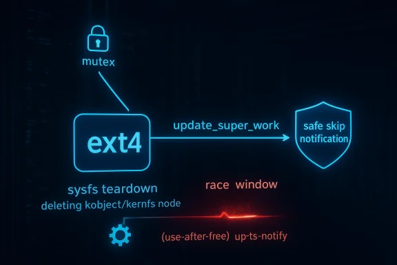

Diagram shows ext4 update path with mutex, safe skip notification, race window, and sysfs teardown.Background​

The specific problem arose after an earlier fix, commit b98535d09179, moved ext4_unregister_sysfs() before flushing s_sb_upd_work. That change was meant to stop new error work from being queued via /proc/fs/ext4/xx/mb_groups reads during unmount. The trade-off was subtle: by tearing down sysfs earlier, ext4 created a new race where update_super_work() could still call ext4_notify_error_sysfs() after the kobject backing the sysfs directory had already been deleted.
That means the bug is not “ext4 forgot to clean up.” It is more specific than that. The teardown order made sense for one race, but it exposed another, and the new failure mode is a classic use-after-free on the kernel object graph. In kernel terms, that is exactly the sort of bug that can remain invisible under normal testing but become dangerous under heavy unmount, recovery, or error-reporting activity.
The upstream description makes the sequence easy to visualize. ext4_put_super() calls ext4_unregister_sysfs(sb), which invokes kobject_del(&sbi->s_kobj). That eventually clears kobj->sd, drops the sysfs directory reference, and frees the underlying kernfs_node. Meanwhile, update_super_work can still reach ext4_notify_error_sysfs(sbi), which calls sysfs_notify(&sbi->s_kobj) and dereferences the stale kobj->sd pointer. The result is a race between teardown and notification, with the loser being memory safety.

The fix does not attempt to reorder the whole unmount path again. Instead, it adds a guard so ext4_notify_error_sysfs() can detect that sysfs has already been torn down and simply skip sysfs_notify() in that case. The test uses s_kobj.state_in_sysfs, which is the correct signal that the sysfs object is no longer live. That is a small change in code, but a large change in safety.

The new locking model​
To close the remaining window, ext4 introduces a dedicated mutex, s_error_notify_mutex, to serialize ext4_notify_error_sysfs() against kobject_del() in ext4_unregister_sysfs(). That prevents a time-of-check/time-of-use gap where sysfs could be present during the state check but gone by the time sysfs_notify() runs. This is the right kind of fix: narrow, explicit, and aligned with the race being patched.
The locking is also important because it acknowledges a real concurrency hazard rather than pretending the sysfs state flag alone is enough. Kernel developers often have to combine a validity check with serialization to make the check meaningful. Without the mutex, the state_in_sysfs test could still become stale before notification. That is the essence of the race.

The Race Condition in Plain English​
At a high level, ext4 is trying to tell sysfs about an error state while the filesystem is being dismantled. If the unmount path tears down the sysfs object first, and the worker thread arrives a little later, the worker may still think it has a valid object to notify. That is how a stale pointer becomes a live kernel memory access.
A simplified timeline​
  • ext4_put_super() starts unmount.
  • ext4_unregister_sysfs() deletes the kobject.
  • sysfs_remove_dir() clears the sysfs link and releases the node.
  • The update_super_work item finally runs.
  • ext4_notify_error_sysfs() calls sysfs_notify() on an object that no longer has a valid kernfs_node.
That sequence is the kind of thing developers dread because it is both narrow and realistic. It does not require exotic input, just the right interleaving between unmount and background work. Concurrency bugs like this are hard to reproduce on demand, but easy to hit eventually in busy environments, especially when filesystems are mounted and unmounted repeatedly or are under error stress.
Why this is a use-after-free​
The key detail is that sysfs_notify() reaches through kobj->sd to obtain the kernfs node. Once kobject_del() and sysfs_remove_dir() have run, that pointer can be stale, and the underlying kernfs_node may already have been freed via RCU. The bug is therefore not a benign null dereference; it is a genuine UAF on freed kernel memory.
