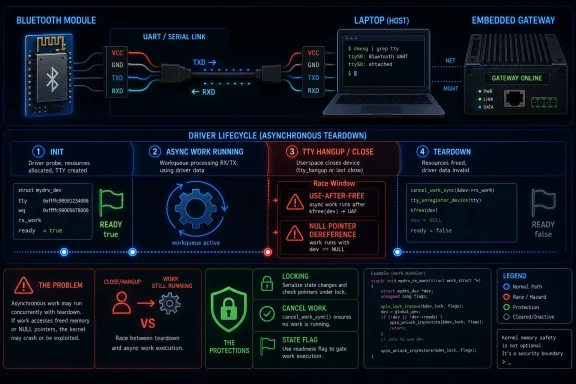

The Flag Was Treated Like a Lock Until It Wasn’t
The core failure described in the CVE is deceptively simple. Thehci_uart close path only flushed or cancelled certain workqueues when the HCI_UART_PROTO_READY flag was set. If a TTY hangup occurred before setup completed, the close routine could skip that cleanup and free the hu structure while work such as init_ready or write_work remained scheduled.That is a dangerous bargain. A readiness flag tells the code whether a protocol finished enough of its initialization to be considered active. It is not automatically proof that no asynchronous worker exists, no callback can fire, and no timer can requeue activity. The bug happened in the gap between logical readiness and actual scheduled execution.
This is why lifecycle bugs in kernel drivers are so persistent. Developers are often not fighting one obvious path but a matrix of almost-paths: normal probe, failed probe, partial setup, hangup, close, suspend, resume, removal, retry, and vendor-specific cleanup. The code that works perfectly when every step happens in order can fail when a user unplugs something, a line discipline changes, a controller misbehaves, or a setup callback returns late.
The fix described by kernel.org moves the close path toward a stricter ordering. It clears
HCI_UART_PROTO_READY first, then immediately cancels write_work synchronously. That order is the important part. Clearing the flag prevents concurrent protocol timers from successfully waking the transmit path again, while cancel_work_sync() waits for any currently queued work to finish or be cancelled before the freed object can become a trap.This is the kind of patch that looks boring until you have debugged one of these failures. It is not adding a mitigation banner or a new security boundary. It is teaching the kernel to stop pretending that “not ready” and “not scheduled” are the same state.

The CVE description lists several related defects, and they all point to one disease: ownership of thehci_uart and hci_dev state was not consistently serialized across the close and error paths. In one case, hci_uart_flush() could race with write_work, leading to a possible double-free of hu->tx_skb. In another, hci_free_dev(hdev) could run before the protocol-specific close callback, even though vendor close routines might still dereference hu->hdev.That second point is particularly important because hardware support code often depends on vendor-specific close callbacks to clean up controller state. A generic core may believe the HCI device is finished, while a vendor backend still expects to inspect or touch it during shutdown. If the free happens before the close, the kernel has created a use-after-free opportunity inside a path that was supposed to be cleaning up safely.
The repair is conceptually straightforward: call
hu->proto->close(hu) before freeing the HCI device, and do it consistently across close and error paths. But consistency is precisely what kernel lifecycle code tends to lose over time. A fast fix for one failure path becomes a special case; a vendor callback grows assumptions; another error path returns early; years later, the codebase contains two subtly different shutdown sequences for the same object graph.The CVE also notes races around
proto_lock and receive handling. In particular, hci_uart_tty_receive() was accessing hu->hdev outside the read-side critical section, which could become unsafe if an initialization error path freed the device concurrently. The fix moves the receive byte accounting into the locked region, a tiny change with an outsized correctness meaning: if the pointer’s lifetime is protected by a lock, the dereference belongs inside that protection.Taken together, these fixes are less about one missing line and more about enforcing a rule. Work must be cancelled before the object it touches is freed. Vendor callbacks must run before the shared state they may inspect is destroyed. Readers must dereference lifetime-protected pointers while the lifetime protection is actually held. None of that is glamorous, but it is what keeps kernel subsystems from becoming timing-dependent roulette wheels.

The Fix Preserves Retry Behavior, and That Detail Matters
One subtle point in the CVE description is the choice ofcancel_work_sync() rather than disable_work_sync(). That may sound like implementation trivia, but it reveals a careful tradeoff. The goal was to drain scheduled work safely without permanently breaking user-space retry behavior.That distinction matters because kernel fixes can easily overshoot. A defensive patch that prevents a race by disabling a work item forever might eliminate the UAF while leaving users unable to recover from failed initialization without a reboot or module reload. Security fixes that degrade normal recovery paths often return as regressions, and regressions pressure maintainers to revert or complicate the patch.
Here, the fix aims to preserve the ability of user space to try again while still making cancellation meaningful in the close path. Clearing the readiness flag first prevents new transmit wakeups from protocol timers, then synchronous cancellation drains the existing worker. It is a narrower correction than a blanket shutdown of the mechanism.
The CVE also notes that clearing
PROTO_READY early causes hci_uart_close() to skip hu->proto->flush() in the TTY close path, and argues that this is safe because hu->proto->close() follows shortly after and purges the protocol queues. That is the kind of reasoning maintainers have to get exactly right. A security fix that changes call ordering must not quietly leak buffers, skip hardware cleanup, or leave a protocol half-alive.This is why kernel security work often looks slower and more meticulous than outsiders expect. The patch is not merely “cancel work before free.” It must consider timers that can requeue work, flush routines that can race with workers, vendor close callbacks that depend on device pointers, initialization errors that run under different locks, and user-space behavior after failure. The vulnerability may be summarized in one CVE paragraph, but the fix lives in a web of invariants.
