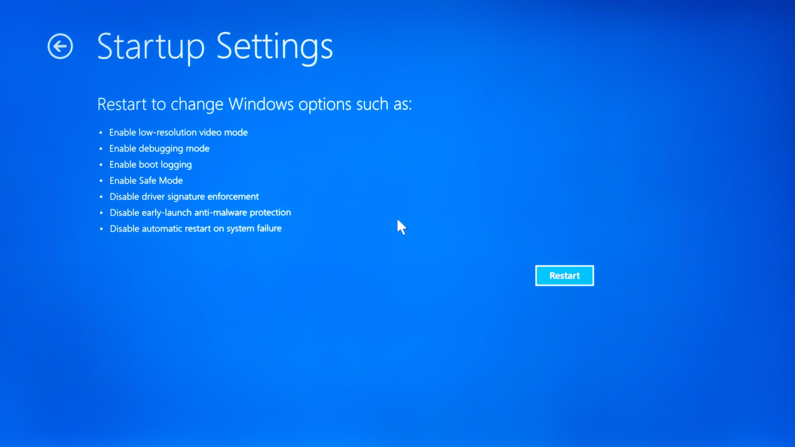

Safe Mode Still Matters Because It Removes the Noise​
Safe Mode can feel like a relic from another Windows era, but it remains one of the cleanest ways to separate core OS and hardware behavior from third-party interference. In Windows 11, booting through Advanced startup into Startup Settings and then Safe Mode loads a reduced environment with only essential drivers and services.
If USB ports work reliably in Safe Mode, that is a clue. It suggests the hardware path is alive and the baseline Windows stack can enumerate the device. The culprit is more likely a third-party driver, endpoint security product, virtualization tool, device management agent, RGB utility, peripheral suite, or some other background service that hooks into device detection.
This is especially relevant on gaming PCs and workstations. Keyboard and mouse suites, headset utilities, capture-card packages, phone-sync tools, motherboard control panels, and USB security products all want a piece of the device stack. Most behave well. Some do not.
The troubleshooting burden then shifts from “fix USB” to “find the offender.” That is slower work: disable startup apps, remove recent driver packages, uninstall peripheral utilities, and check whether the problem began after a known software install. Safe Mode does not solve the problem by itself; it narrows the field.
If USB still fails in Safe Mode, the diagnosis moves in the other direction. That does not prove hardware failure, but it makes third-party software less likely. At that point, controller reinstall, chipset drivers, firmware settings, and physical inspection become more important.
