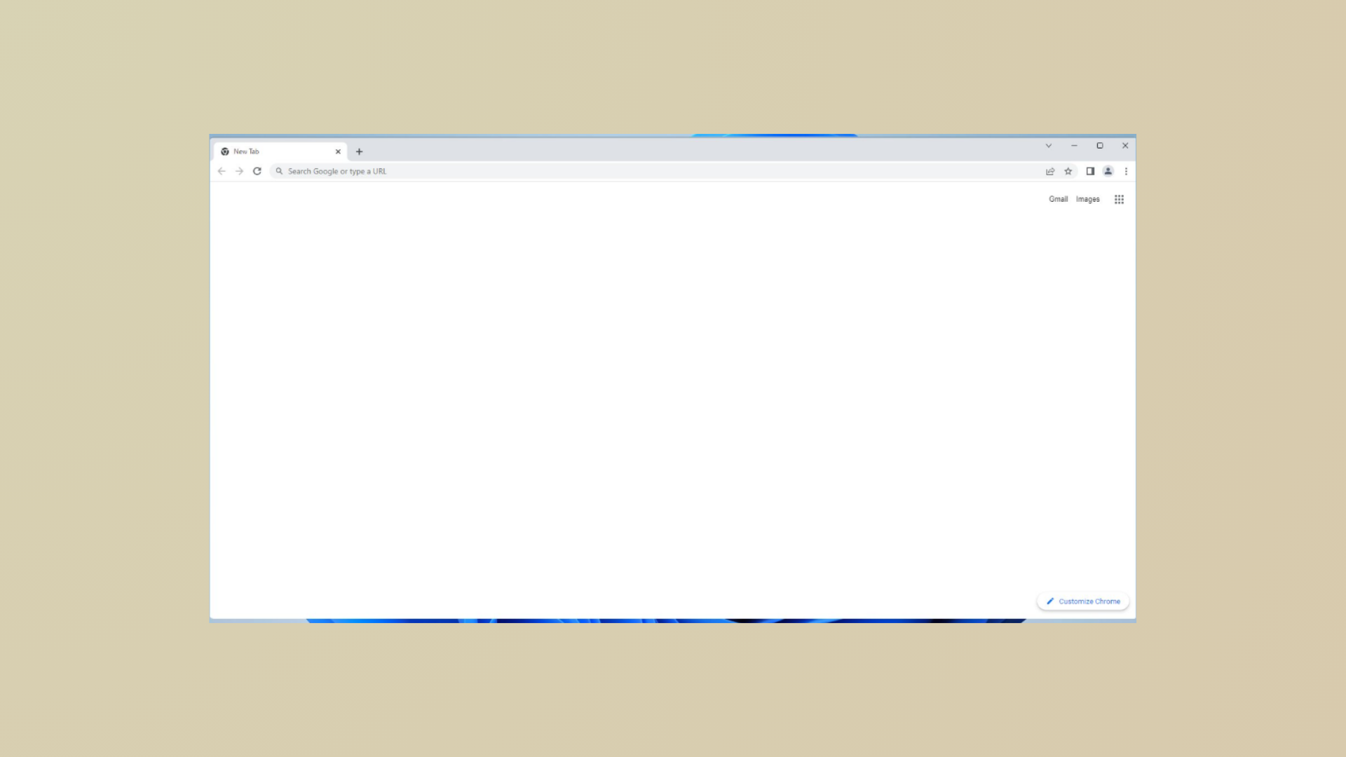

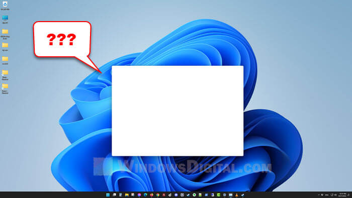

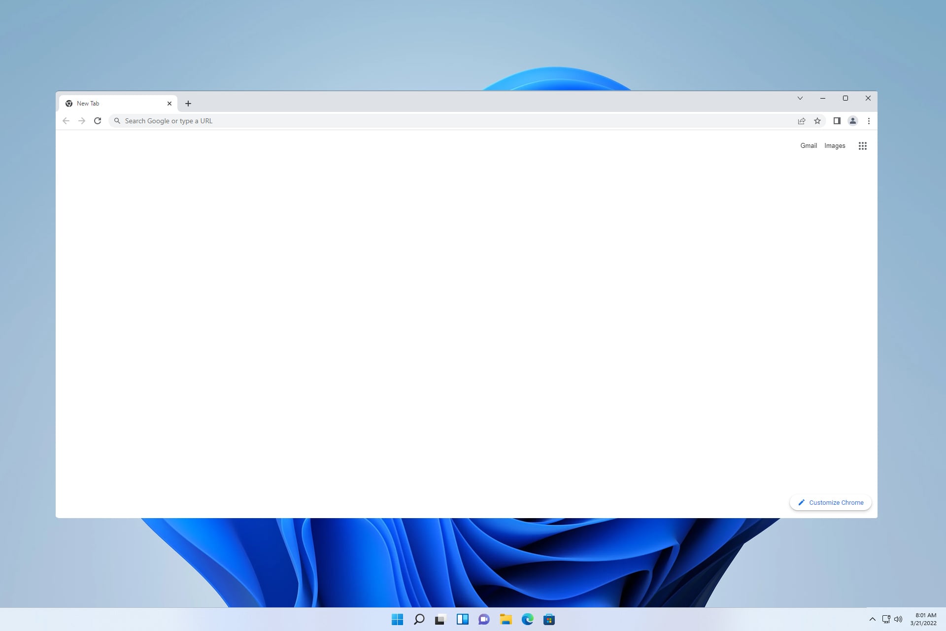

The White Box Is Small News With a Big Windows Lesson
The bug, at least as users are describing it, is almost comically plain: a blank white rectangle appears, usually in the top-left of the screen, and then either vanishes after a few seconds or sits long enough to interrupt work. There is no useful error message, no application title that explains itself, and no obvious owner. It is the sort of symptom that makes a normal user suspect malware and makes an admin suspect one more background updater that forgot it was supposed to stay in the background.That is why this report is more interesting than another transient desktop glitch. Windows users are not complaining about a blue screen, a failed cumulative update, or a dead GPU path. They are complaining about a ghost window: a UI artifact from something that apparently should not have had a visible UI in the first place.
According to the WindowsReport write-up, affected users have seen the issue on both Windows 10 and Windows 11, and community reports mention systems built on Intel and AMD hardware. That breadth weakens the tidy theory that this is a single driver stack or one vendor’s graphics control panel misbehaving. If the same sort of window appears across Windows generations and hardware families, the more plausible suspect is a user-space process that runs at login, startup, or unlock.
The reported name of that suspect is the most revealing part. Users on Reddit and ElevenForum have pointed to a Task Scheduler folder called
GoogleUserPEH, and specifically to a task called RunPlatformExperienceHelperOnUnlock. The name practically announces its job: run Google’s Platform Experience Helper when the user unlocks Windows. The problem is that users are not seeing an “experience.” They are seeing a white rectangle with no explanation.Chrome Is No Longer Just an App You Open
